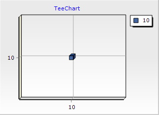

I tried this code (TeeChart AX 2023 and VB6:
added a Pojnt Series to Chart. No other changes.
Private Sub Command1_Click()
  TChart1.AutoRepaint = False
  TChart1.Series(0).AddXY 10, 10, "", clTeeColor
  TChart1.AutoRepaint = True
  TChart1.Repaint
End Sub
It painted ok. Maybe worth checking with a basic run away from your project to confirm that no other settings are interfering.
