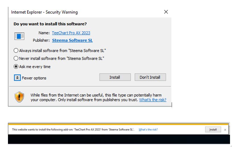

Hi Team,
I've taken latest TeeChart(TeeChart2023_0_2_23_ActiveX3264.exe) and used the TeeChart202364.cab file in my web application.
While accessing my application TeeChart202364.cab files are not installing on edge browser,Enabled activeX controls and trusted site with internet options from edge browser,But still i couldn't find installing cabinet file on the client machine.
Can you please look into it and let me know if you are able to install and execute TeeChart202364.cab files?
Thanks!

Re: TeeChart .cab files are not installing and executing
Attached screenshot of .cab files not installing
Hi Team,
So this means,TeeChart cab files will not be working with edge browser?
Is there a way to make it working?This will be blocker for our functionality where this was working earlier with 2021 version.
I will provide you some inputs, may be you can looking in to it.
Thanks!
Srikanth Ananthoju
- Enable the Edge browser in the IE compatibility mode and verify from your end to address the issue in 2023 version.
TeeChart Pro 2021 version works with latest edge browser in IE compatability mode but TeeChart 2023 doesn't works
Thanks!
Srikanth Ananthoju
