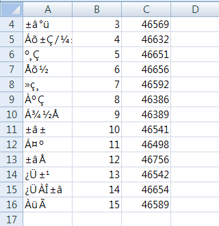

The test code I used VC2013.
CExport pExport = m_TeeChart.GetExport();
CXLSExport pXlsExport = pExport.GetAsXLS();
pXlsExport.SetIncludeHeader(TRUE);
pXlsExport.SetIncludeLabels(TRUE);
pXlsExport.SetIncludeIndex(FALSE);
pXlsExport.SaveToFile("c:\\Test.xls");
Korean is broken as shown below.

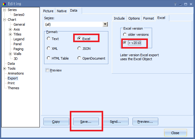

Test result "> 2010" option does not break Korean.
Edting Option.png (19.25 KiB) Viewed 25297 times
So I want to use the "> 2010" option but I can not find the TeeChart2018.ocx function.
Please tell me how I can use the "> 2010" option using VC2013.
Re: Export to Excel have korean issue.
Posted: Thu Sep 27, 2018 9:33 am
by yeray
I'm afraid the exportation to .xlsx hasn't been implemented yet in TeeChart ActiveX so it can only be used from the editor, inheriting the feature from TeeChart VCL. This is a feature already in the wish list for the next releases: #1670.
