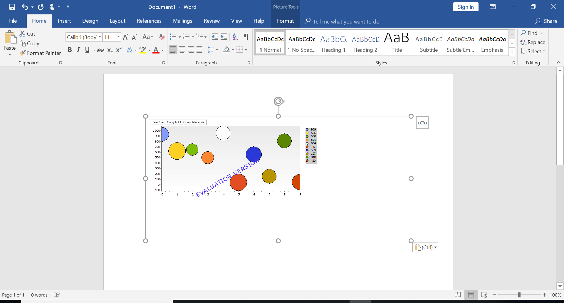

When running on displays that have DPI scaling enabled (i.e. 125% or 150%, etc.) the export of the charts to EMF or WMF format appear smaller than the original, however the overall image size is the correct dimensions so you get a smaller chart appearing in the top left of an image. Is there a way to get this type of export to work correctly on systems that have the system wide zoom factor set to anything other than 100%? This issue happens with Windows 7, 8 and 10.
