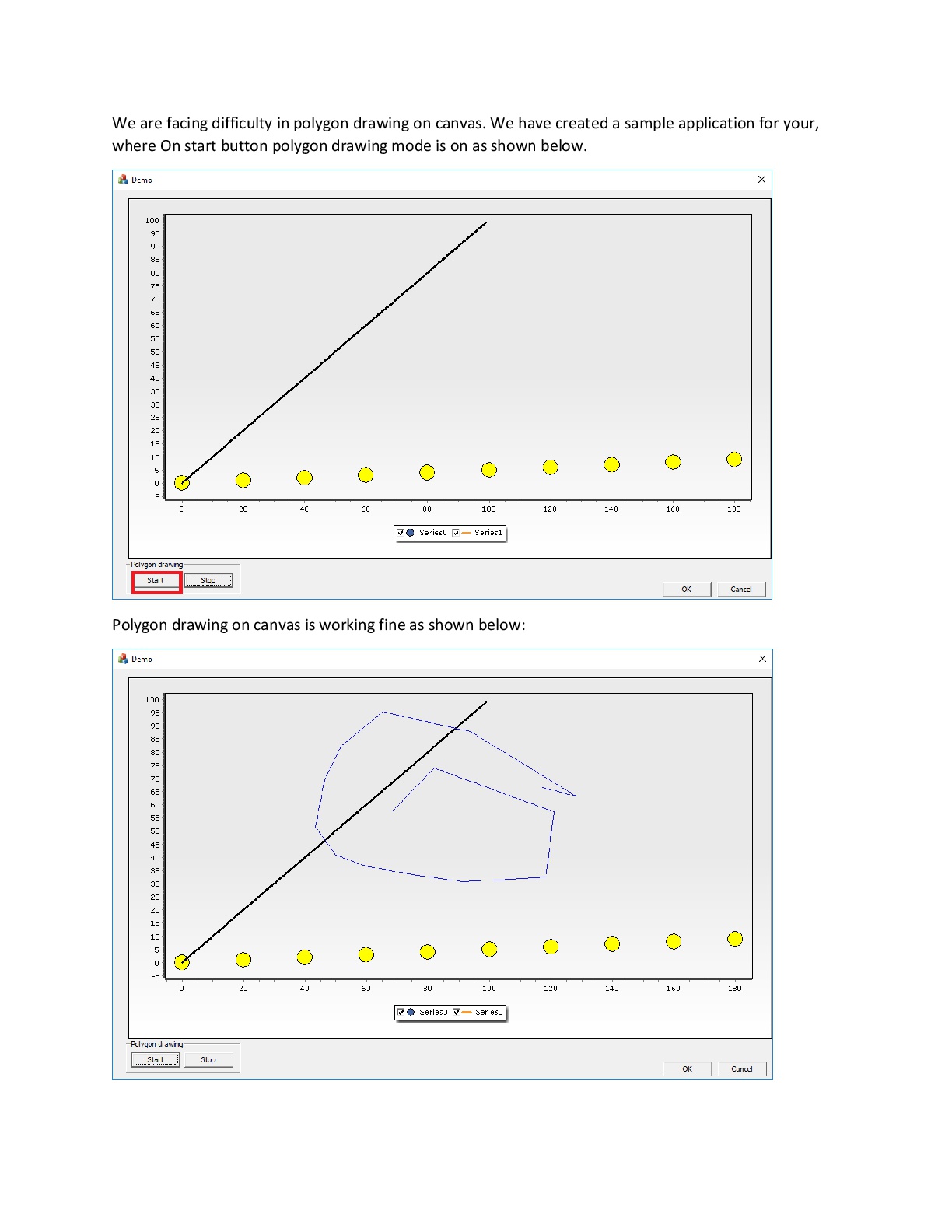

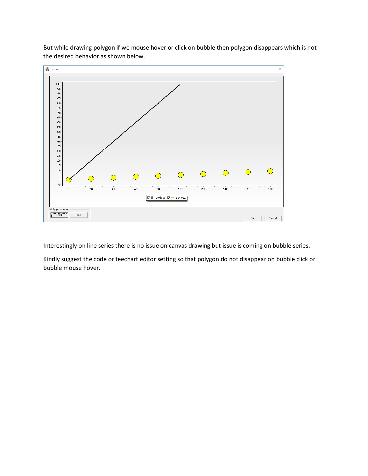

We have recently migrated to the latest version of T-Chart i.e. ActiveX 2018. But after migration we are facing difficulty in polygon drawing on canvas which was working fine earlier. Polygon drawing on canvas while working on line-series is working fine. But while drawing polygon, if we mouse hover or click on bubble series then polygon disappears which is not the desired behavior. Interestingly on line-series there is no issue on canvas drawing but the issue is coming on bubble series.
Kindly suggest the code or teechart editor setting so that polygon do not disappear on bubble click or bubble mouse hover.

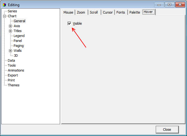

I can't find any test application attached but, according to your description, the problem may disappear as soon as you disable the Hover feature by code or at design time:
- By code:
    TChart1.Hover.Visible = False
- At design time:
