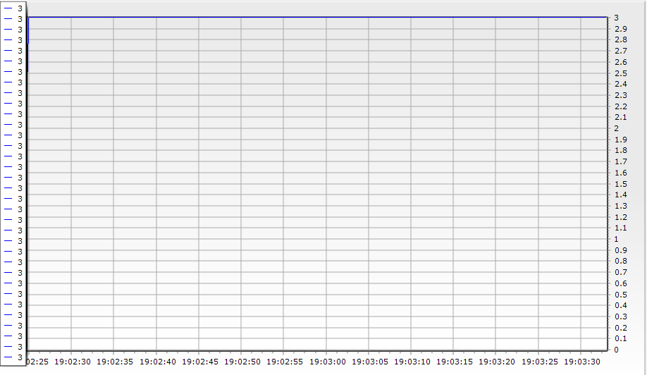

I want to use custom legend, my code is:
	CLegend legend = (CLegend)m_tchart.get_Legend();
	legend.put_Visible(TRUE);
	legend.put_CustomPosition(TRUE);
	legend.put_LeftPercent(80);
	legend.put_TopPercent(5);
But the result is: legend.png

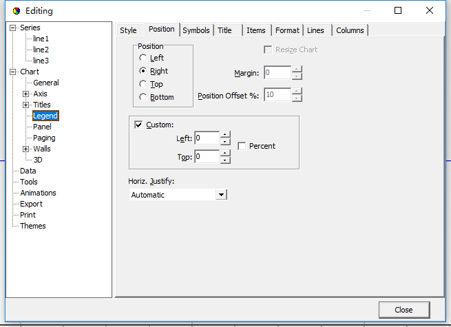

I open the edit, found "percent" is not checked. as attached file: edit.png.
can you help me to find what's wrong whith my code?
thank you!
Posts: 9712
Re: Tchart Custom Legend
Post by Yeray » Mon Jan 22, 2018 8:50 am
Add this to set position to percent units:
legend.put_PositionUnits(puPercent);
