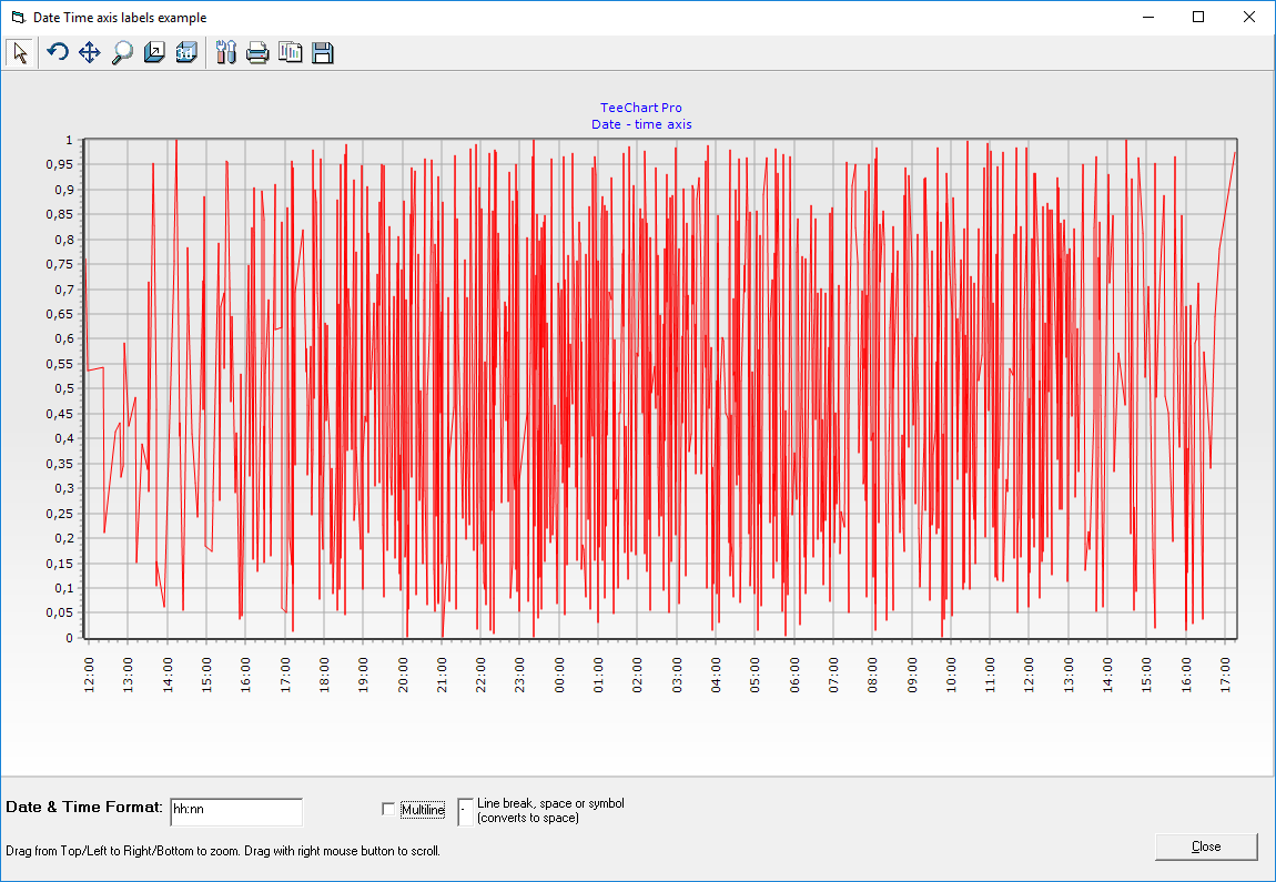

This image is an example, simple VB demo (adapted from example demos shipped with TeeChart AX 2017):
The example uses variably spaced x data at intervals of less than an hour. The asp code should work on this in exactly the same way. I've added the VB(6!) project to this post.
