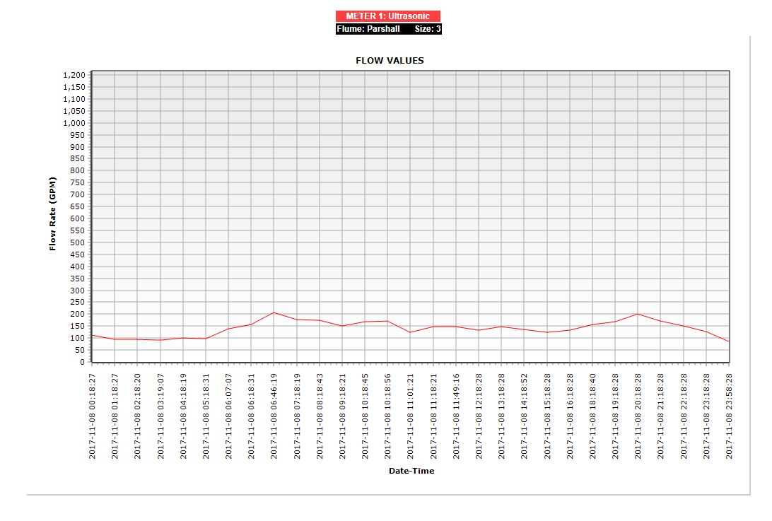

I have recently updated a version 5 application. It uses ASP pages and ADO. Here's a snippet of code:
'DATE/TIME
AChart.Axis.Bottom.Increment = AChart.GetDateTimeStep(dtOneHour)
AChart.Axis.Bottom.Labels.DateTimeFormat = "hh:nn" '****version5 used AChart.Axis.Bottom.Labels.DateTimeFormat = "hh:mm"
AChart.AddSeries(scLine)
AChart.Series(0).Color = vbRed
AChart.Series(0).XValues.DateTime = True
AChart.Series(0).Datasource = Rs
AChart.Series(0).YValues.ValueSource="Value"
AChart.Series(0).LabelsSource="DateTime" '**** version5 used Chart.Series(0).XValues.ValueSource="DateTime"
I expect to have the DateTime on the X axis:
1. be divided into 1 hour segments via AChart.Axis.Bottom.Increment = AChart.GetDateTimeStep(dtOneHour)
2. display DateTime format of hours:minutes via AChart.Axis.Bottom.Labels.DateTimeFormat = "hh:nn"
But it does not display that way. Doesn't seem to be any formatting of the Y axis at all. Is there some order that is required? I feel like I've tried everything to no avail. I have the ASP source code as well as the results of the SQL query but the forum does not allow me to upload.

I see you are setting the "DateTime" field to the Series' LabelsSource:
As you said, in v5 you used:
AChart.Series(0).XValues.ValueSource="DateTime"
I'm not sure to understand why did you change this, but this seems to be the reason of the problem.
- Adding values to a series without specifying the X values, the X values array is populated with a succession of 0, 1, 2,... That's why there's the same horizontal distance between all the points in your result.
- By default, the axis Labels.Style is set to talAuto, and when the axis has a series with labels attached, these labels are used to draw the axis labels. The DateTimeFormat only is considered when displaying values in the axis, not when displaying the labels (strings).
