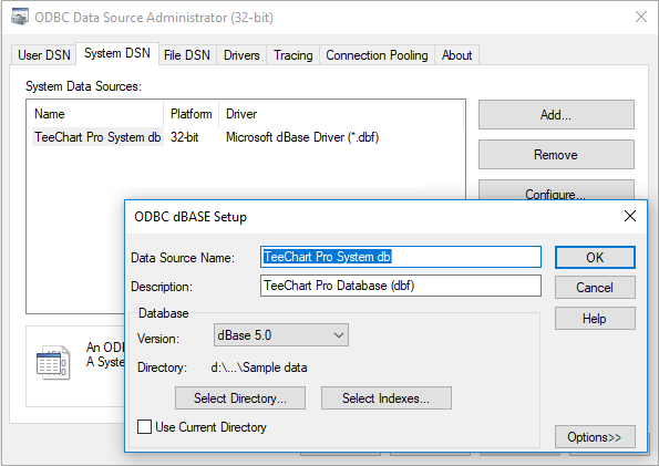

To correctly run the ADO example, please check that you have a System DSN entitled "TeeChart Pro System db" managed via the 32 ODBC Manager.

The public demo resides on x64 Windows 2012. It uses the 32Bit ODBC driver to access the datasource (as screenshotted in my earlier post on this thread).
