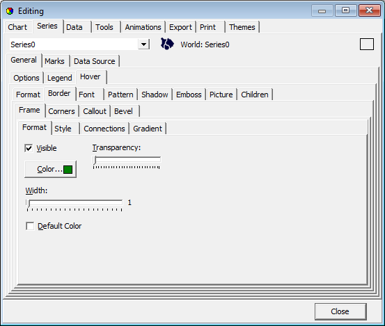

You can modify the Series Hover through the editor:
However, I'm afraid you can't do the same by code. I've added it tot he public tracker:

Thanks Yeray. Does not seem to work for me. I change it as per your screenshot but it reverts when I look at the dialog in the screenshot again. WIll not change to the colour I set or the thickness.
I'm using WinDev 21.

by yeray
What TeeChart ActiveX version are you using?
