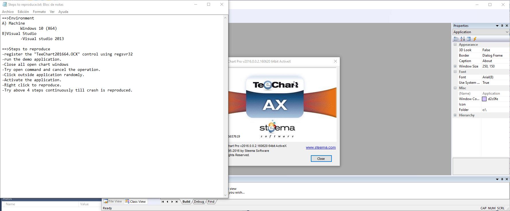

We have developed a sample application to demonstrate the crash in STEEMA charting control.
The application has been developed in Visual Studio 2013 and run on a windows 10 machine.
The below listed files have been uploaded to STEEMA server (under SNPSUSER user):
a) Source Code for a demo application (ZIP file)
b) Screen Recording (ZIP file)
c) Steps to reproduce (TXT file)
Please help investigate and fix the crash ASAP.
Awaiting your response, Thanks in advance.

Post by Yeray » Fri Feb 17, 2017 8:59 am
I haven't been able to reproduce the problem.
I've added a call to m_ctrlChart.AboutBox() to show the TeeChart version registered / in use.
