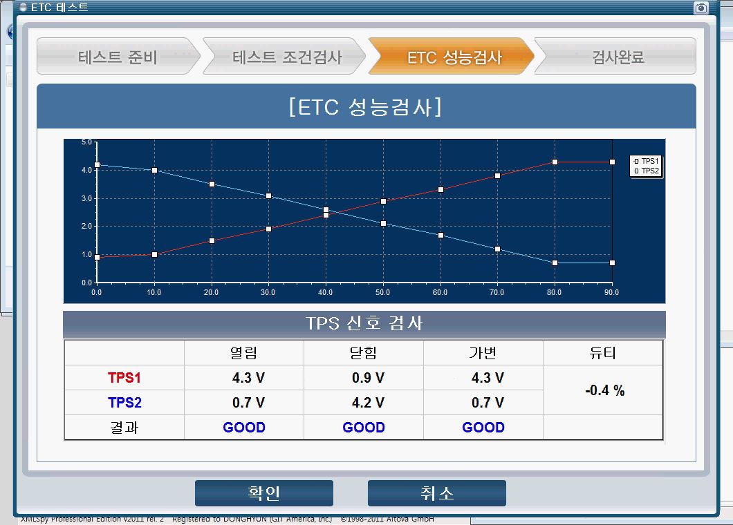

The problem is line color on the Graph does not change.
The attached file is a sample program and existing program screen.
Please check it out and reply to us.

GIT wrote:The problem is line color on the Graph does not change.
I'm not sure if the problem is in the lines and the image you attached shows the desired result or if the problem is that the pointers are white.
If the problem is in the lines, try changing the code in where you are adding points (in the timer) for this:
		m_TChart1.Series(0).AddXY(m_nData-1, (m_nData/2), L"", m_TChart1.Series(0).GetColor());
		m_TChart1.Series(1).AddXY(m_nData-1, (m_nData/2)+1, L"", m_TChart1.Series(1).GetColor());
If the problem is in the pointers, just remove the part where you are assigning them to be white:
	//m_TChart1.Series(0).GetAsLine().GetPointer().GetBrush().SetColor(RGB(255,255,255));
	//m_TChart1.Series(1).GetAsLine().GetPointer().GetBrush().SetColor(RGB(255,255,255));
