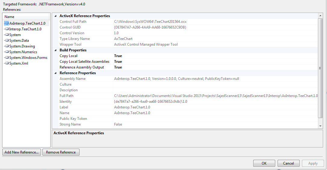

I download trial version of TeechartActivex2015 and install it.
I create a simple project in vs2013 c++/cli and add this component successfull.

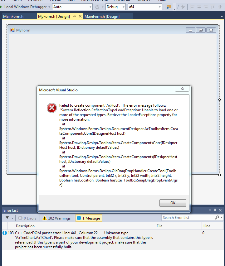

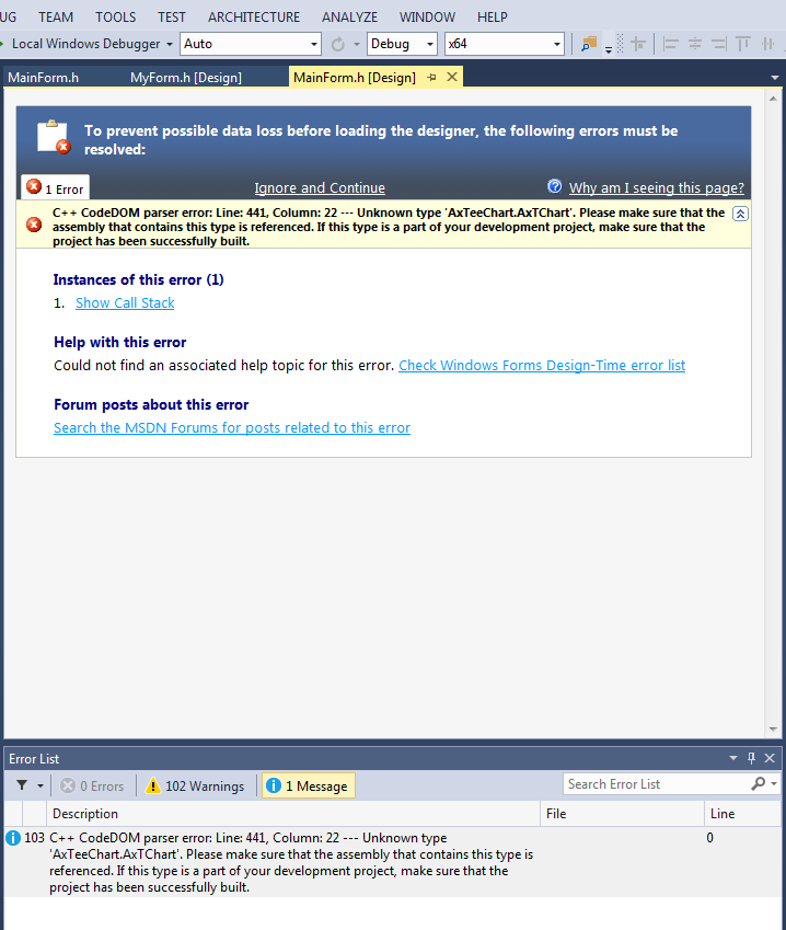

1-when i want open form designer that include teechart component i received this error message :
Message 103 C++ CodeDOM parser error: Line: 441, Column: 22 --- Unknown type 'AxTeeChart.AxTChart'. Please make sure that the assembly that contains this type is referenced. If this type is a part of your development project, make sure that the project has been successfully built. 0
2- when i want add teechart from toolbox to new form(in current project) i received this error message :
Failed to create component 'AxHost'. The error message follows:
'System.Reflection.ReflectionTypeLoadException: Unable to load on or more of the requested types. Retreive the LoaderExceptions property for more information.
at System.Windows.Forms.Design.DocumentDesigner.AxToolboxItem.CreateComponentsCore(IDesignerHost host) ....
one other strange is that in this project that designer is corrupted and has a problem with teechart component and doesnt open designer. if I Start Program , i can use teechart component in runtime. form shows teechart correctly and works fine.
finally I add errors snapshot for better understanding

Failed to create compnent 'AXHost'.
