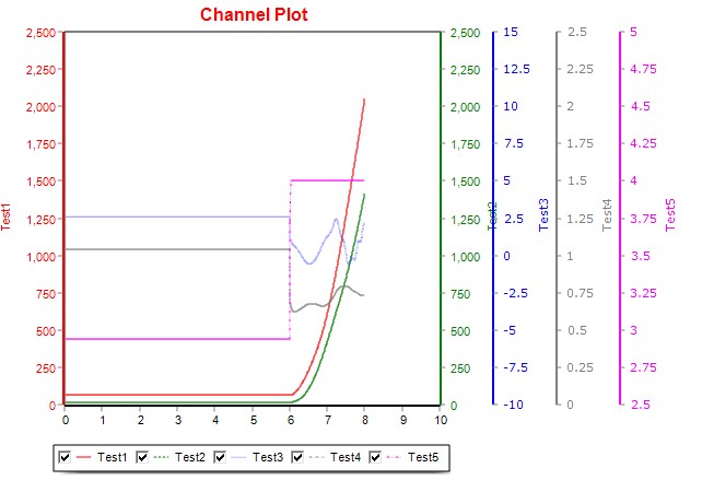

I place my legend at the bottom of my chart. As I add more series and thus more custom axes, my legend gets resized. But I want it to display as many columns at possible, so as to be aligned with the right border of the chart panel. What is the legend property that will allow me to do this?
I've attached an image:
Image of Legend not aligned correctly

Hi nbp,
You can either try using Legend.NumCols property or the OnGetLegendRect event as explained in tutorial 5. TeeChart Pro ActiveX tutorials can be found at the Docs folder included with TeeChart's installation or at http://www.teechart.net/docs/.
If the problem persists please attach a simple example project we can run "as-is" to reproduce the problem here.
