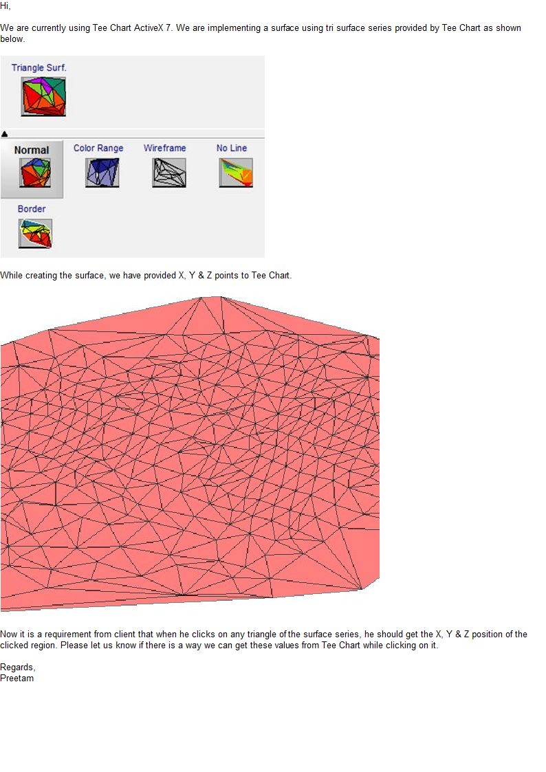

Tri surface series get x,y,z value
The surface series, he should get the X, Y & Z position of the clicked region. Please let us know if there is a way we can get these values from Tee Chart while clicking on it. Please see the attached file for detail .
- 3dplotting.jpg (132.38 KiB) Viewed 23662 times

You can do this:
You can do this:
Private Sub Form_Load()
TChart1.AddSeries scTriSurface
TChart1.Series(0).FillSampleValues
End Sub
Private Sub TChart1_OnMouseDown(ByVal Button As TeeChart.EMouseButton, ByVal Shift As TeeChart.EShiftState, ByVal X As Long, ByVal Y As Long)
Index = TChart1.Series(0).Clicked(X, Y)
If Index <> -1 Then
Me.Caption = "X: " & CStr(TChart1.Series(0).XValues.Value(Index)) & _
", Y: " & CStr(TChart1.Series(0).YValues.Value(Index)) & _
", Z: " & CStr(TChart1.Series(0).asTriSurface.ZValues.Value(Index))
End If
End Sub

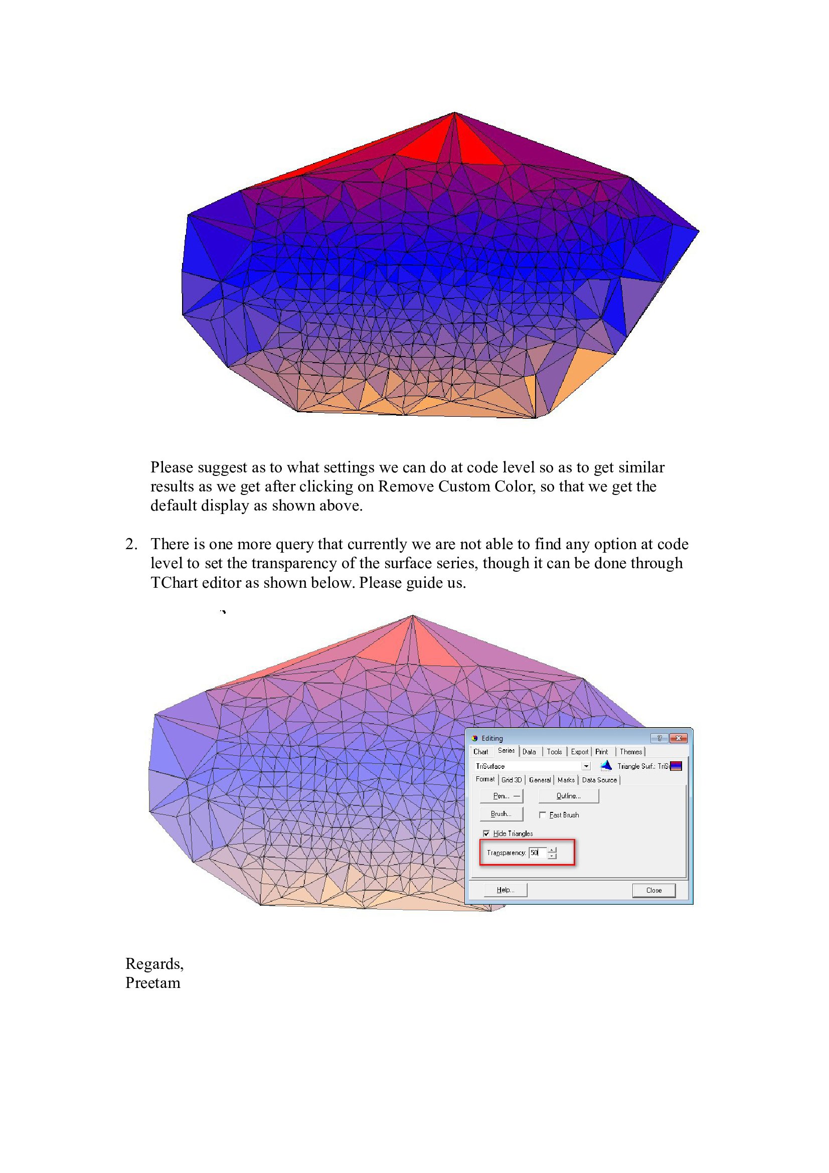

- 845b2aeeb0cfcbe0-1.jpg (415.69 KiB) Viewed 23544 times

Re: Tri surface series get x,y,z value
Hi Preetam,
Regarding your technical inquiries:
1. What Remove custom colors button does is resetting all points to be clTeeColor, default color. Either populate your series using this color constant or don't use any color at all. A complete example that sets colors as you wish is this:
2. Set series' Transparency property as shown in the code example above.
TChart1.Series(0).FillSampleValues 100
TChart1.Series(0).Transparency = 50
TChart1.Series(0).asTriSurface.UseColorRange = True
TChart1.Series(0).asTriSurface.UsePalette = False
TChart1.Series(0).asTriSurface.StartColor = RGB(255, 0, 0)
TChart1.Series(0).asTriSurface.MidColor = RGB(0, 0, 255)
TChart1.Series(0).asTriSurface.EndColor = RGB(255, 173, 91)
End Sub
