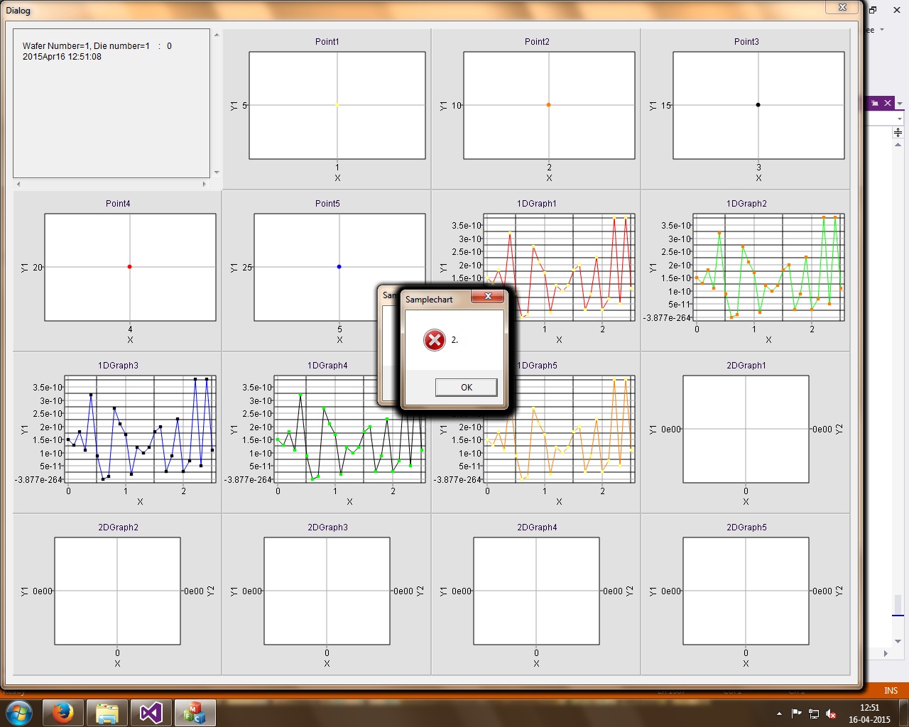

I am using TeeChart Pro v2013.0.1.4.131120 32bit ActiveX in an MFC application. There are 15 chart windows dynamically created on a dialog running on a UI thread and all of the charts windows get constantly updated by messages from the main thread. I am encountering the following issues:
1. An abnormal message box with "2." written inside constantly pops up once after the chart windows are created and updated.
2. Although at regular interval I am freeing the data for each chart with the following code I find that memory is continuously getting accumulated.

Before reviewing the code I suggest just build and run the code just once and you get to see the abnormal message box. There is no such message box in the code and I am sure its coming from inside the activex. I suspect that the message box is due to some kind of exception because everytime the message come I find something like this in the output window:
"First-chance exception at 0x7503D3CF (KernelBase.dll) in SampleChart.exe: 0x0EEDFADE (parameters: 0x044686AD, 0x0C9895D0, 0x00000002, 0x00000000, 0x04327D24, 0x06CAD4EC, 0x06CAD4D4)."

Please make sure that you are using TeeChart Pro v2013.0.1.4.131120 32bit ActiveX control on Visual Studio 2013. For your reference I am attaching a screen dump of the output.

I've ran this version of the application, that seems to create 10 windows with 2 charts each, and after a while I got the "2" message box.
