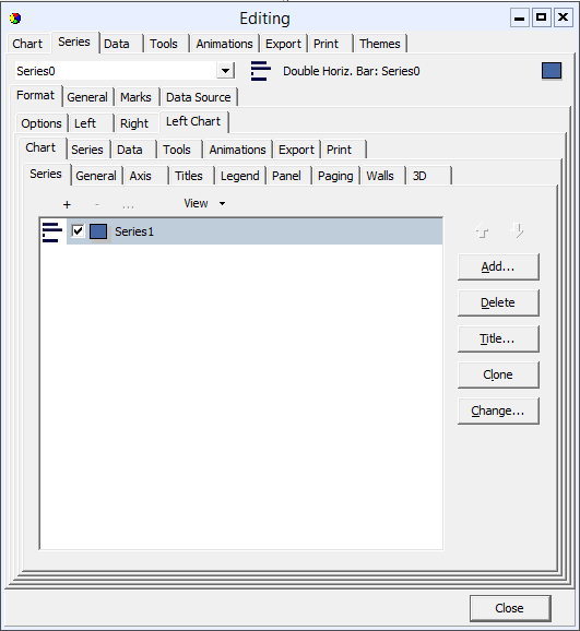

The DoubleHorizBar is a quite new series and it's a quite particular one: In short, the right part is a regular HorizBar series and the left part is actually a SubChart with another HorizBar series.
If you add the series at design time, you can see the "Left Chart" tab in the series editor:
So you should work with the main chart and with this subchart to access the left part.
If there's anything more specific you are finding troubles with, don't hesitate to let us know.
