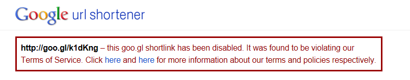

Re: TeeChart2014.0.0.2 in Japanese system
I got the email but the link is not ok.
See the attached image:
[img]LinkNotOk.PNG[/img]
- LinkNotOk.PNG (14.03 KiB) Viewed 40207 times
Excuse me. I'm sending it again.
