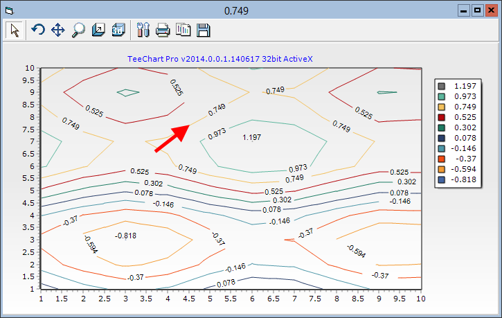

I've made a simple example in VB6 to check this:
Private Sub Form_Load()
  TChart1.Header.Text.Clear
  TChart1.Header.Text.Add TChart1.Version
  TChart1.Aspect.View3D = False
  TChart1.AddSeries scContour
  TChart1.Series(0).FillSampleValues
  TChart1.Series(0).Marks.Visible = True
  TChart1.Series(0).Marks.Transparent = True
  TChart1.Series(0).asContour.Filled = False
End Sub
Private Sub TChart1_OnClickSeries(ByVal SeriesIndex As Long, ByVal ValueIndex As Long, ByVal Button As TeeChart.EMouseButton, ByVal Shift As TeeChart.EShiftState, ByVal X As Long, ByVal Y As Long)
  If (SeriesIndex >= 0) And (TChart1.SeriesCount > 0) And (TChart1.Series(SeriesIndex).Count > 0) And (ValueIndex >= 0) Then
    Caption = Format$(TChart1.Series(SeriesIndex).asContour.Levels.Items(ValueIndex).UpToValue, "#0.###")
  End If
End Sub

I see the event is fired when you click on the levels, not when you click on the filled area.
How would you expect it to work?
