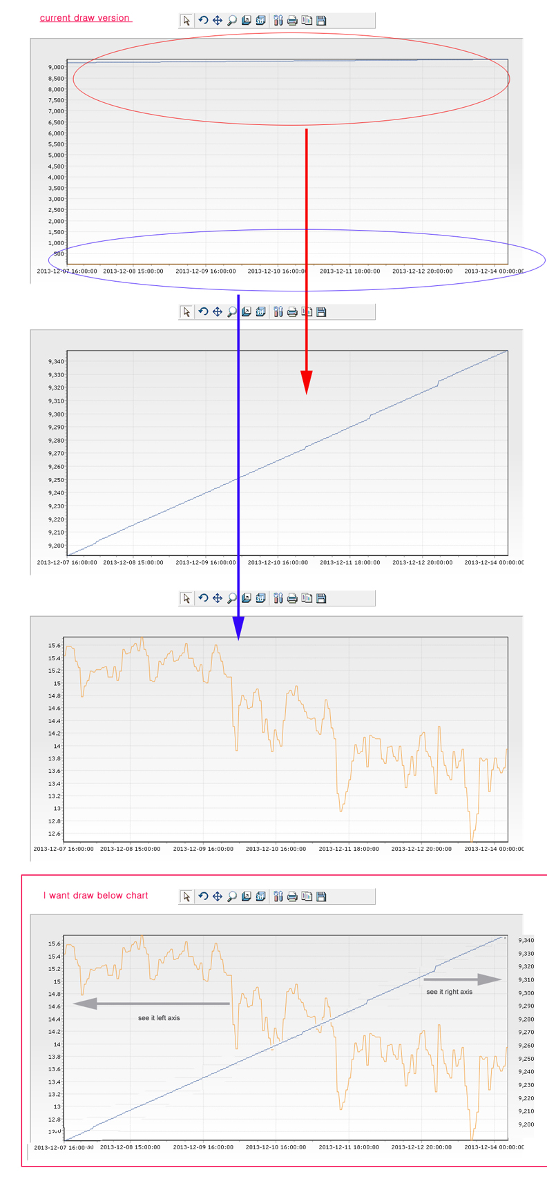

I would like to refer to the Right Y-axis and the graph. See this remarkable document or sample?
Thank you for your help... ^^

If you want use the two vertical axes, you need only set the VerticalAxis property of Series to both. See code below as example:
Private Sub Form_Load()
TChart1.Aspect.View3D = False
TChart1.AddSeries (scFastLine)
TChart1.Series(0).FillSampleValues
TChart1.Series(0).VerticalAxis = aBothVertAxis
End Sub
