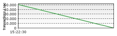

I have a line chart. I set the Title for YAxis. But the title is not positioned correctly. It is not at the start, center or end and it is cut.
The text should be "transactions / sec".
See attachment.

The text looks to be too long for the chart height.
I'd suggest you to set a smaller font size.
Alternatively, I'd suggest you to try with an Annotation tool instead of using the Axis Title.

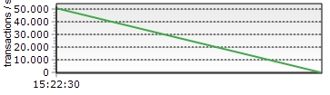

This is how it looked with TeeChart2012.ocx. The same text and the positioning was correct.

First note the two images you've posted have a different size. One is 373x115 and the other is, as you said, 363x105.
Anyway, I see the difference appeared in TeeChart VCL v2013.09 (note TeeChart ActiveX is a wrapper form TeeChart VCL).
I'll add this to the public tracker to be revised for future releases.
http://bugs.teechart.net/show_bug.cgi?id=825
In the meanwhile, the only workaround I can think on wound be using an Annotation tool instead of the Left Axis Title. Ie:
