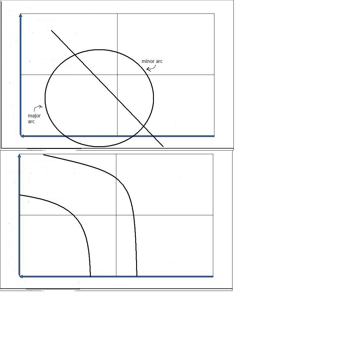

I have attached a jpegs with 2 images the first is of a circle bisected by a line. Can you provide an example showing the same circle displaying the major arc and an example displaying the minor arc.
From what I can determine the first two coordinate pairs of the arc parameters determine the rectangle that the circle/ellipse will be inscribed in, it's the other 2 coordinate pairs that are confusing me. I can't make any sense out of why I sometimes get the major arc and sometimes get the minor arc.
The second chart image shows basically what I'm trying to accomplish. I need to draw two large curves cutting through most of the chart area. The shapes are not exact but I think I could accomplish the result using two minor arcs of ellipses that were much larger than the chart area and centered off the chart to the left.
If there is an easier way to draw a curve on the chart I'd love to here it.
Thanks!

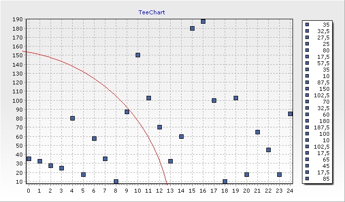

According to the documentation link in my previous post, using this code:
Private Sub Form_Load()
    TChart1.Aspect.View3D = False
    TChart1.AddSeries scPoint
    TChart1.Series(0).FillSampleValues 25
    Me.ScaleMode = vbPixels
End Sub
  TChart1.Canvas.Pen.Color = vbRed
  TChart1.Canvas.Arc -TChart1.Width / 2, 100, TChart1.Width / 2, TChart1.Height * 2, TChart1.Width / 2, TChart1.Axis.Bottom.Position, TChart1.Axis.Left.Position, TChart1.Axis.Left.IStartPos
End Sub
You get this:

Post by az7523 » Tue Nov 19, 2013 3:55 pm
Thankyou! The delphi description explains how it works very well.
