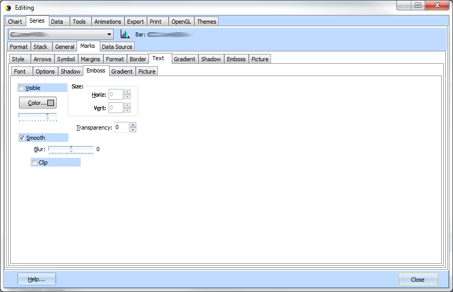

How can I get access to Series->Marks->Text->Emboss from C++
jhameenniemi
Posts: 17
Joined: Mon Apr 15, 2013 12:00 am
Post by jhameenniemi » Thu Nov 14, 2013 8:21 am
TeeChart Pro v.2013.0.1.0 and MS VC++ 2010.
How can I get access to Series->Marks->Text->Emboss from C++? series.GetMarks().GetFont() has GetShadow(), GetOutline(), etc. but not GetEmboss(). series.GetMarks() has GetEmboss() but that's Series->Marks->Emboss i.e. not what I need.
BR,
Tero
Re: How can I get access to Series->Marks->Text->Emboss from C++
Post by Narcís » Thu Nov 14, 2013 9:06 am
Hi Tero,
This is a bug. I have added it (ID99) to bugzilla to be fixed for next releases. If you sign up in bugzilla you can track its progress including your email at the CC List.
