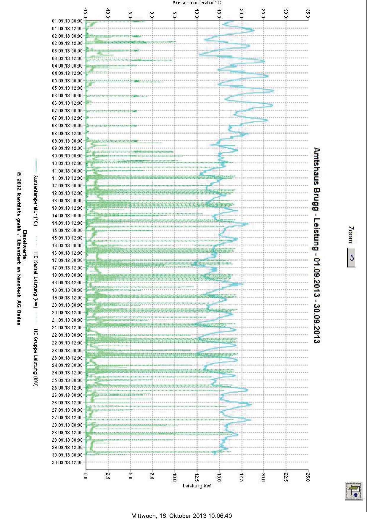

- Screen 2013
- Screen_2013ocx.jpg (349.23 KiB) Viewed 40728 times

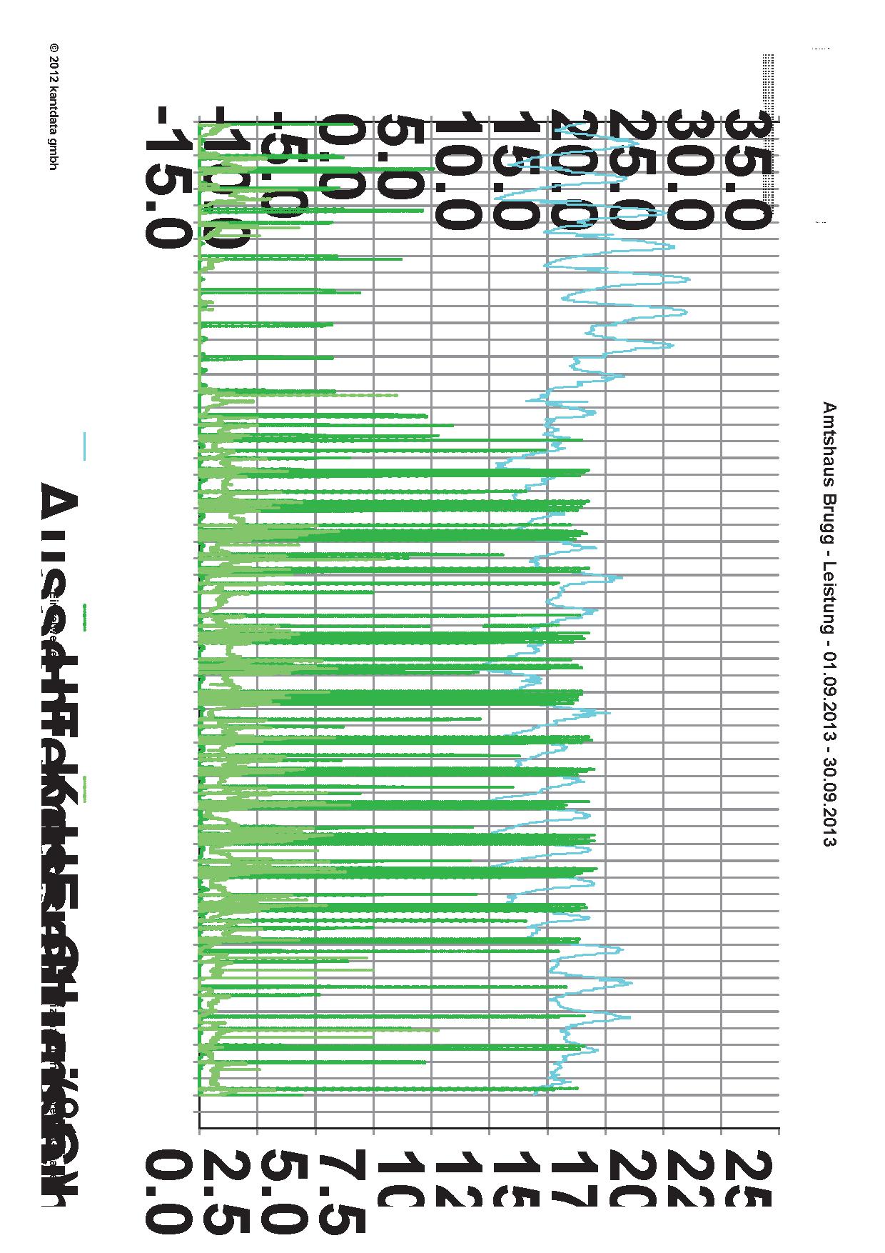

- Print 2013
- Print_2013ocx.jpg (368.9 KiB) Viewed 40671 times

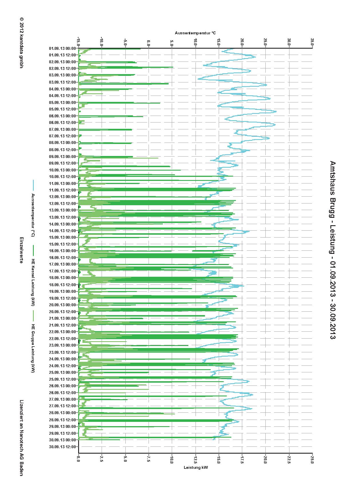

- Print 2012
- Print_2012ocx.jpg (340.3 KiB) Viewed 40676 times

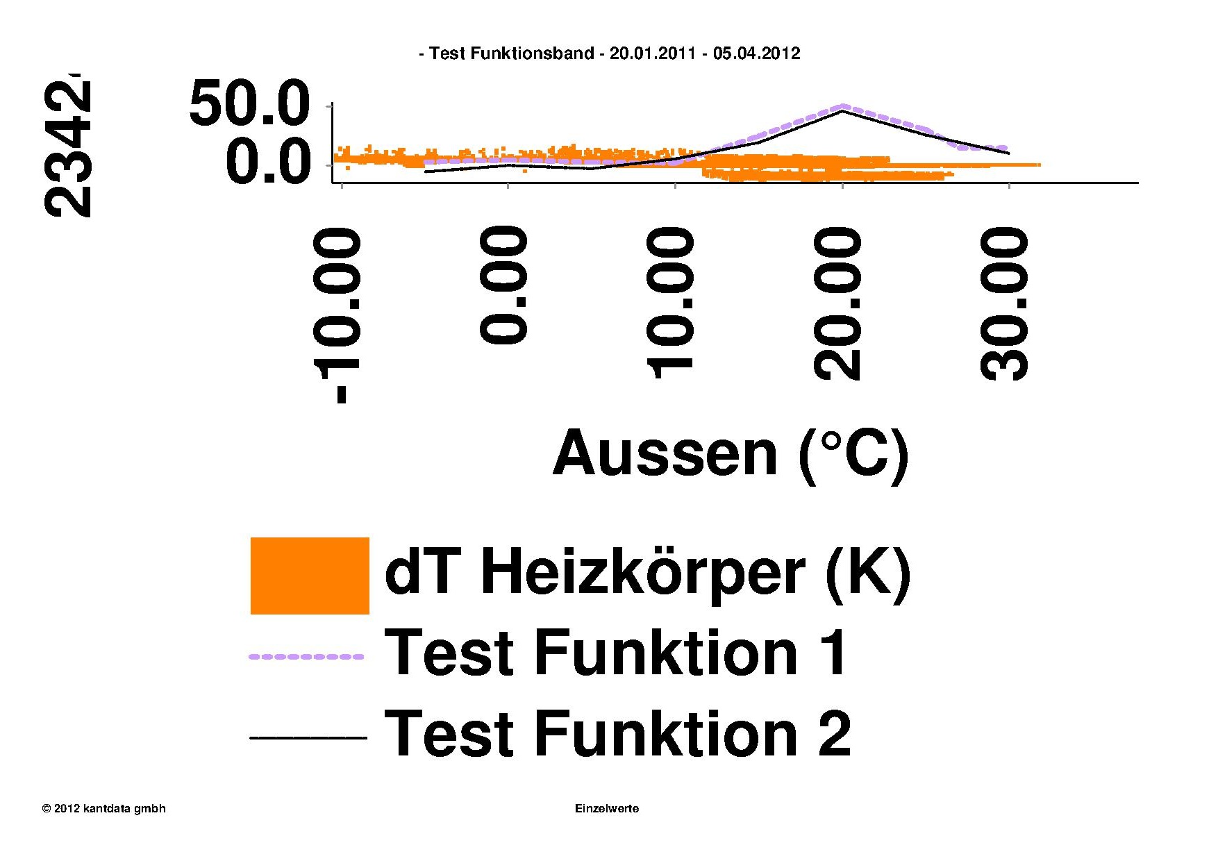

Re: Labels and Titles way too large when printing
Hi Narcis
Thanks for your test OCX.
We are not quite there yet - see the enclosed JPEG's.
Please note that that title and footer text
are directly on the MS Access form/report,
not on the TeeChart control.
Best wishes,
Andreas
Best wishes,
Andreas

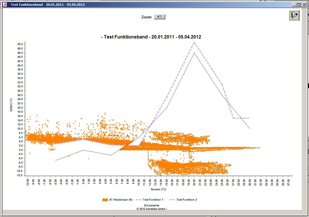

- TeeChart2014_Print.jpg (222.24 KiB) Viewed 40507 times
- TeeChart2014_Screen.jpg (165.02 KiB) Viewed 40523 times
