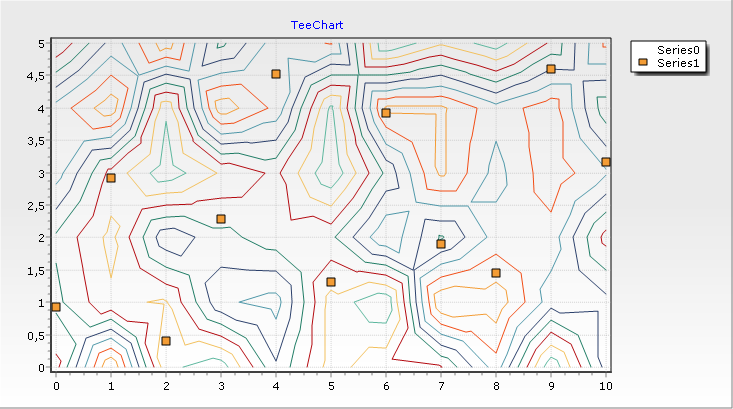

Re: How Contour serie is used???
Hi David,
Once you have a Contour series populated (as Narcís explained above) you can add an extra Point series to draw the points you wish.
Here it is an example:

TChart1.Aspect.View3D = False
Dim x, z As Integer
TChart1.AddSeries scContour
With TChart1.Series(0).asContour
For x = 0 To 10
For z = 0 To 5
.AddXYZ x, Rnd * 10, z, "", clTeeColor
Next z
Next x
.IrregularGrid = True
End With
TChart1.AddSeries scPoint
For x = 0 To 10
TChart1.Series(1).AddXY x, Rnd * 5, "", clTeeColor
Next x

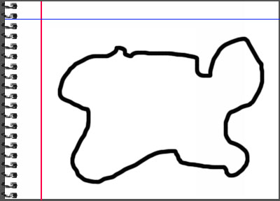

hi narcis,
I've already check those tutorials and that isn't exactly what I'm looking for.
maybe if you could help me with this, for example how can I draw an irregular shape like the one that is attached, wich series could be used for doing something like that.
David
Hi David,
What about a MapSeries?
Take a look at the exmaple included in the demo at "All Features\Welcome !\Chart styles\Extended\Map GIS"
And here you'll find a simple example of how to draw a triangle:
http://www.teechart.net/support/viewtop ... =3&t=14336
