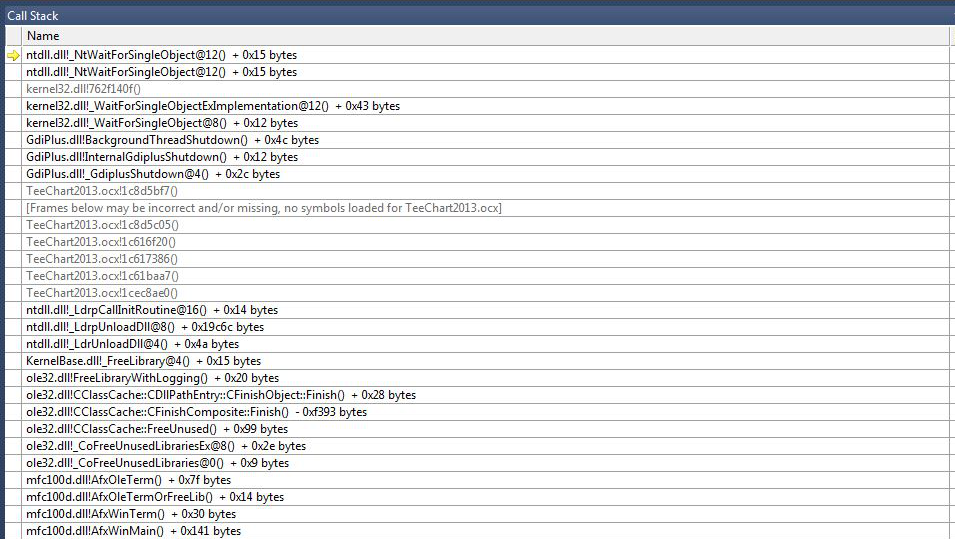

Unfortunately we cannot reproduce this problem using a simple test program. Here is a call stack from our application:
Call stack.PNG (303.72 KiB) Viewed 45259 times
As we do not have symbols for TeeChart we cannot look any further to the problem ourselves. If you have any suggestions how to proceed feel free to contact privately by email as we cannot provide any more specific information in a public forum.

OK. We found the reason for the deadlock. TeeChart calls GdiplusStartup and GdiPlusShutdown which it should not do. Here is a Remark section from MSDN for GdiplusStartup:
Remarks
Do not call GdiplusStartup or GdiplusShutdown in DllMain or in any function that is called by DllMain. If you want to create a DLL that uses GDI+, you should use one of the following techniques to initialize GDI+:
- Require your clients to call GdiplusStartup before they call the functions in your DLL and to call GdiplusShutdown when they have finished using your DLL.
- Export your own startup function that calls GdiplusStartup and your own shutdown function that calls GdiplusShutdown. Require your clients to call your startup function before they call other functions in your DLL and to call your shutdown function when they have finished using your DLL.
- Call GdiplusStartup and GdiplusShutdown in each of your functions that make GDI+ calls.
An example program included. If you comment out GdiplusShutdown call from MainFrm.cpp line 69 process is terminated correctly otherwise it is not terminated. The correct solution is that TeeChart does not call these functions but implements some of the mechanisms outlined in the remarks section above.
