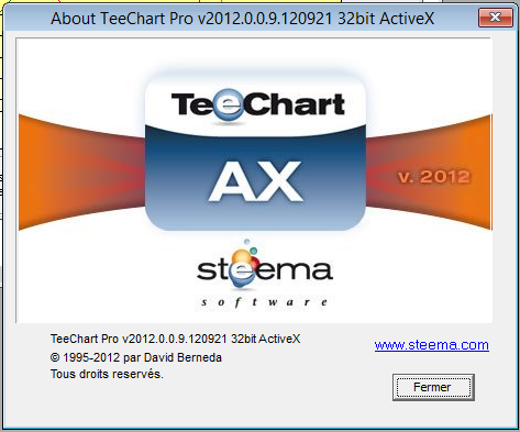

What TeeChart build are you using?
Re: asAxisBreaks --> Access violation
V2012.0.0.9 120921 and I use Windows 8
- TEECHARTBUILD.PNG (109.2 KiB) Viewed 26432 times
