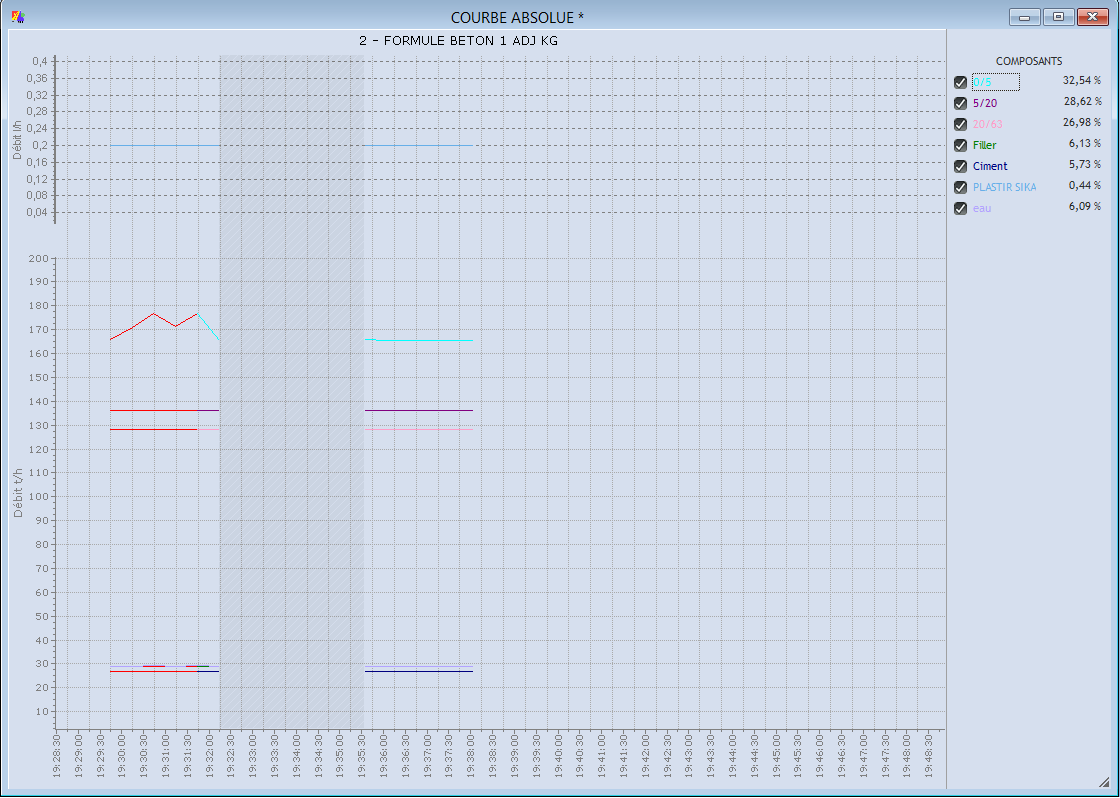

look at the first attachment,
I have 7 scline in a chart with multiple axes on the Y axis
Scline one is attached to the first custom axis (0.04 to 0.4)
the other 6 are attached to the second custom axis (0 to 200)

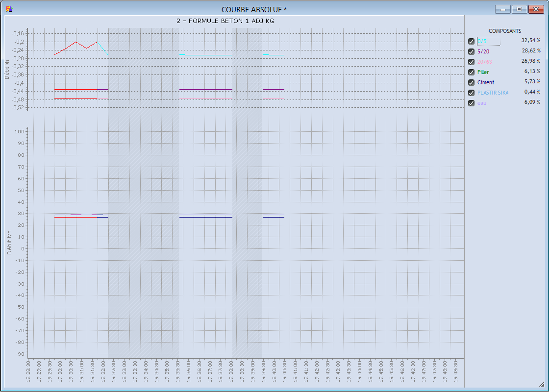

when I scroll up the second chart (0-200), the scline reach the first chart (see the second attachment)
the scline should not exceed the limits of their axis, they must disappear.
Note: this chart has 2 axis customs. On axis Y.
Has No custom chart this axis is absice.
How to scline that remain within the limits of their axes.

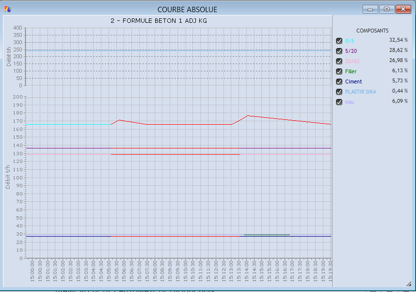

Re: scroll in chart scline, with multiple axes
Thank you very much.
but is it possible to scroll in one or other of the chart. I do not want to scroll all the chart at the same time
i have a chart with one main axis
and one custom axis
thank you
and one custom axis
thank you
- AXE MULTIPLE 3.PNG (30.35 KiB) Viewed 13410 times
To scroll/zoom each zone individually you should disable the default scroll/zoom feature and implement your version of it.
For example, this seems to work in the opaque zones example mentioned above:
