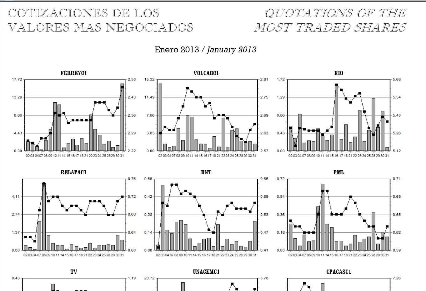

I am creating a combined graphic, in which I am modifying the axes, minimum and maximum. But for some reason, in certain cases, the first left axis label, is not drawed. How I can fix it?
In the example, only the graph for the stock RELAPAC1, has that problem :?
Best Regards

Hi Yeray
Thanks for your support, but the problem continues, even with including your suggestion.
This is part of my code, the values for wMinY1,wMaxY1 and w_Step, are calculated, depending the values for each stock
Grafico.TChart1.Axis.Left.SetMinMax wMinY1, wMaxY1
Grafico.TChart1.Axis.Left.Increment = w_Step
Grafico.TChart1.Axis.Left.MaximumOffset = 1
w_EjeY = wMinY1
With Grafico.TChart1.Axis.Left.Labels
.Clear
For i = 1 To 5
.Add w_EjeY, Format$(w_EjeY, "##,##0.00")
w_EjeY = w_EjeY + w_Step
Next i
End With
