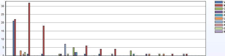

Is there a way, in a bar charts series, to not display the null points (not empty spaces)?
Thank you

Setting a value to be a null point only changes its color to transparent. The other points aren't reordered when you set a point as null.
Note when you add a point with only YValue, the XValue is internally created.
If you want the value to completely disappear, I'd just remove it and reorder the points manually.

Thank you for your quick answer. I did not know that I could use the method AddXY() on Bar chart series. I always use Add() and AddNull().
I tried to use AddXY() but, it the same thing. I don't know if it is possible, but I would like to do not display empty spaces if i dont have data?

Yes, it is similar. I do not want add an AxisBreak but, I would like change the position in the series. I know how get the x position with CalcXPos CalcXPosValue and CalcXSizeValue, but how set the new position?
Thank your for your help.

Rousseau wrote:I would like change the position in the series. I know how get the x position with CalcXPos CalcXPosValue and CalcXSizeValue, but how set the new position?
The only way is to change the XValue of the point.
However, in your case maybe you could just have 10 dummy series for the legend. These are series without points but the appropriate color and title for the legend.
And then a unique Bar series with all the points, so all the values in it will be one next to the other. Of course all these values will have their own color. And this series could have ShowInLegend = false.
