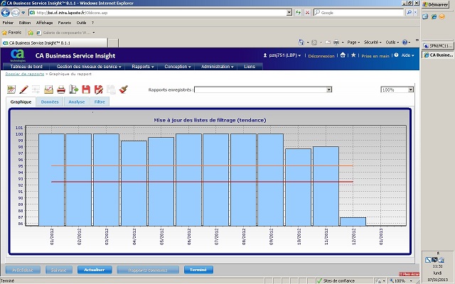

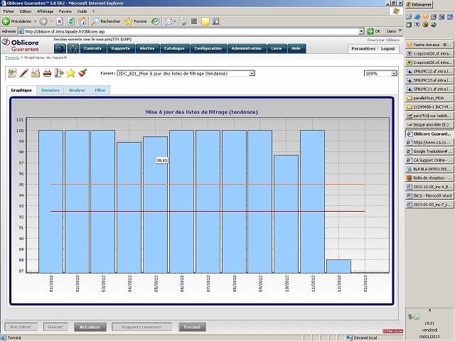

We found out that when displaying a graph, in Teechart V7, when the mouse was pointing the bar of a graph histogramm, it displayed a buble info with the value of the indicator.
But in Teechart V2010, the buble info disappear.
Would you please tell me how to add the buble info?
Tiger
Re: MOUSE POINTING HISTOGRAMS
Posted: Fri Jan 11, 2013 6:33 am
by 16661989
Teechart V7
Teechart V2010

1. my codes is for JScript. I hope you can send my demo codes for JSCript. thanks
2. I have uploaded two images. we need not to display all bubbles. If move mouse pointer to one column, TChart will display value of the column.
I have uploaded my codes, please see the attached. Can you help me to analyze my codes? thank you so much.
