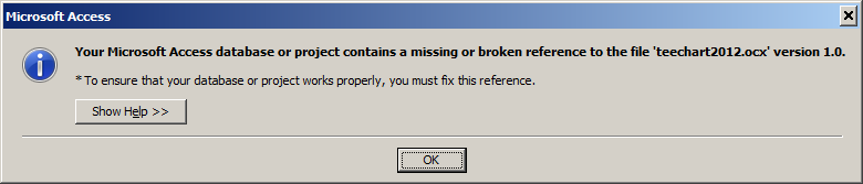

Andrea Cavalleri wrote:Everything seems to be correct but after some clicks (passing from form view-mode to structure-mode and viceversa), the form loses the activex reference.
I get the error below when opening or closing the application you've sent. However, I don't seem to get any error when switching between view and structure modes. Is this the error you are getting?
