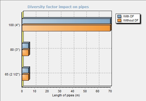

Recently I updated my TeeChart OCX previous version 8.0.0.5 to the last one 8.0.1.3. And I have now a problem with some of my graphs in my program without changing any piece of code.
Here, the main part of the initialization code of my graph (I don't put all the code that are not necessary for the problem):
m_TChartValves.AddSeries( scHorizBar );
m_TChartValves.Series( 0 ).GetAsHorizBar().SetMultiBar( mbSide );
m_TChartValves.Series( 1 ).GetAsHorizBar().SetMultiBar( mbSide );
m_TChartValves.Series( 0 ).GetAsHorizBar().SetAutoBarSize( TRUE );
m_TChartValves.Series( 1 ).GetAsHorizBar().SetAutoBarSize( TRUE );
m_TChartValves.Series( 0 ).GetAsHorizBar().SetBarStyle( bsRectGradient );
m_TChartValves.Series( 1 ).GetAsHorizBar().SetBarStyle( bsRectGradient );

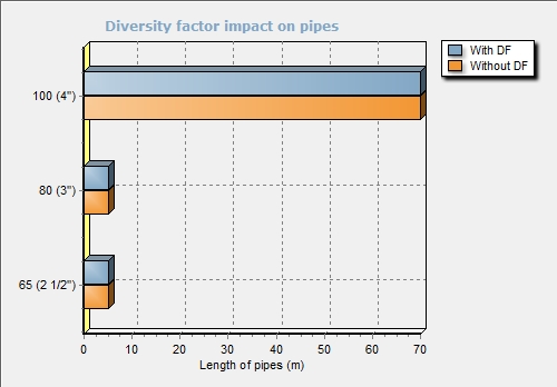

As you can see in the image attached, in version 8.0.0.5, the blue horizontal bar well overrides the orange bar (there are both on the same z-axis coordinate). But with the last update the orange bar overrides the blue one (as if the blue bar is drawn deeper on the z-axis).
How can I change that to retrieve my first graph version? Is there new properties or another that I can use ?
Thanks a lot four your help.
François
Good version
2012-10-09 - v8.0.0.5.jpg (59.47 KiB) Viewed 7386 times
Bad version
2012-10-09 - v8.0.1.3.jpg (59.74 KiB) Viewed 7378 times
Re: MultiBar.mbSide property problem with update 8.0.1.3
Post by Yeray » Tue Oct 09, 2012 2:01 pm
Hi François,
You are right. This was broken with v8.0.1.0, but it works fine with the actual v2012.0.0.7. So the options I see:
- Upgrade to the actual v2012.0.0.7
- Go back to v8.0.0.8.
- Try to find a workaround for the latest v8, v8.0.1.3. I can't think on anyone right now. Note the Bar series has been deeply modified in v2012.
