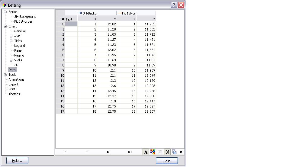

After struggling some time I got the answervector working.
Now the results the answervector presents puzzle me. Below a screenshot of the used data. On the left are the x, y-values of the raw data, on the right are the x,y-vaules of the linear (PolyDegree=2) fit.

The fit looks good and plausible on graphics.
When retrieving the corresponding answervector the following two numbers are presented:
answervector[1]=0.272339
answervector[2]=0.079659
Putting the same (raw) data in MS-Excel and fitting a linear trendline through it, the following line is produced; y=0.079659x+11.172680.
So, the calculated slope (0.079659) looks OK (assuming answervector[2] represents the slope with a linear fit).
The offset which TC calculates however looks way off (0.272339 vs. 11.172680).
Could you please explain what is going on.
