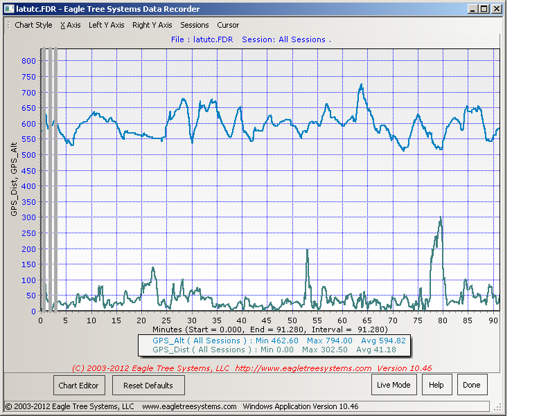

We do not use bar graph, we use line graph. Please see the attached image to get idea about our graph style.
Have you tried with line graph? Please try that, you may understand our problem.
