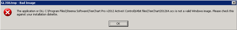

I tried to install the new release on two Windows 2003 server R2 32bit. I got one error on both of the machines. I attached the snapshot.
- install error snapshot
- 2012_install_error.png (6.32 KiB) Viewed 21366 times

Hi Chen,
Right, we've seen this message appears in Win XP and Win 2003 x86 OS as the new version includes a 64bit version of the ocx. In the next releases, we'll try to provide two versions of the installer: one containing only the 32bit version of the ocx, and one containing both the 32bit and the 64bit versions of the ocx.
Anyway, the installation process ends and the 32bit ocx works fine in your 32bit system, isn't it?
