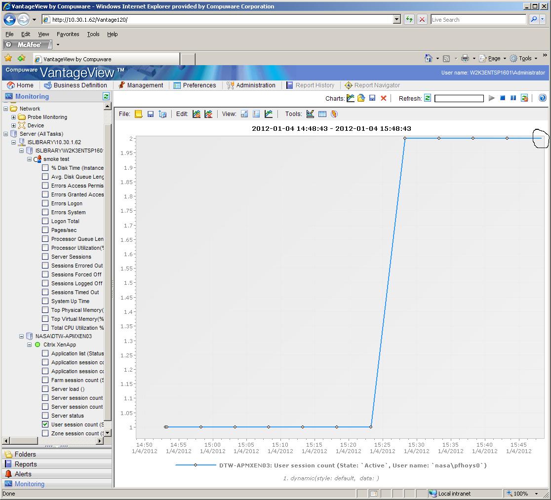

After upgrading to ActiveX 2011 we do not see the lst MARK in a line series. The datapoint is active, so we can view tooltips even for that point, but the mark is missing. Here is some client-side code we have dealing with marks and the image below it.

example of missing mark

I did some further testing on this. This problem seems to only happen on wide-screen monitors. Standard width monitors show the mark properly. This also only happens with ActiveX. If an image file is loaded then the mark appears at the last point.

I was not using maintenance release 5 at the time. I had 4 for the test. Is there a known issue that you resolved with 5?

Yes, take a look at this thread (note TeeChart AX is a wrapper from the VCL version so the changes applied to the first also affect the second)

Maintenance release 5 appears to have fixed this issue. Thank you very much! :D
