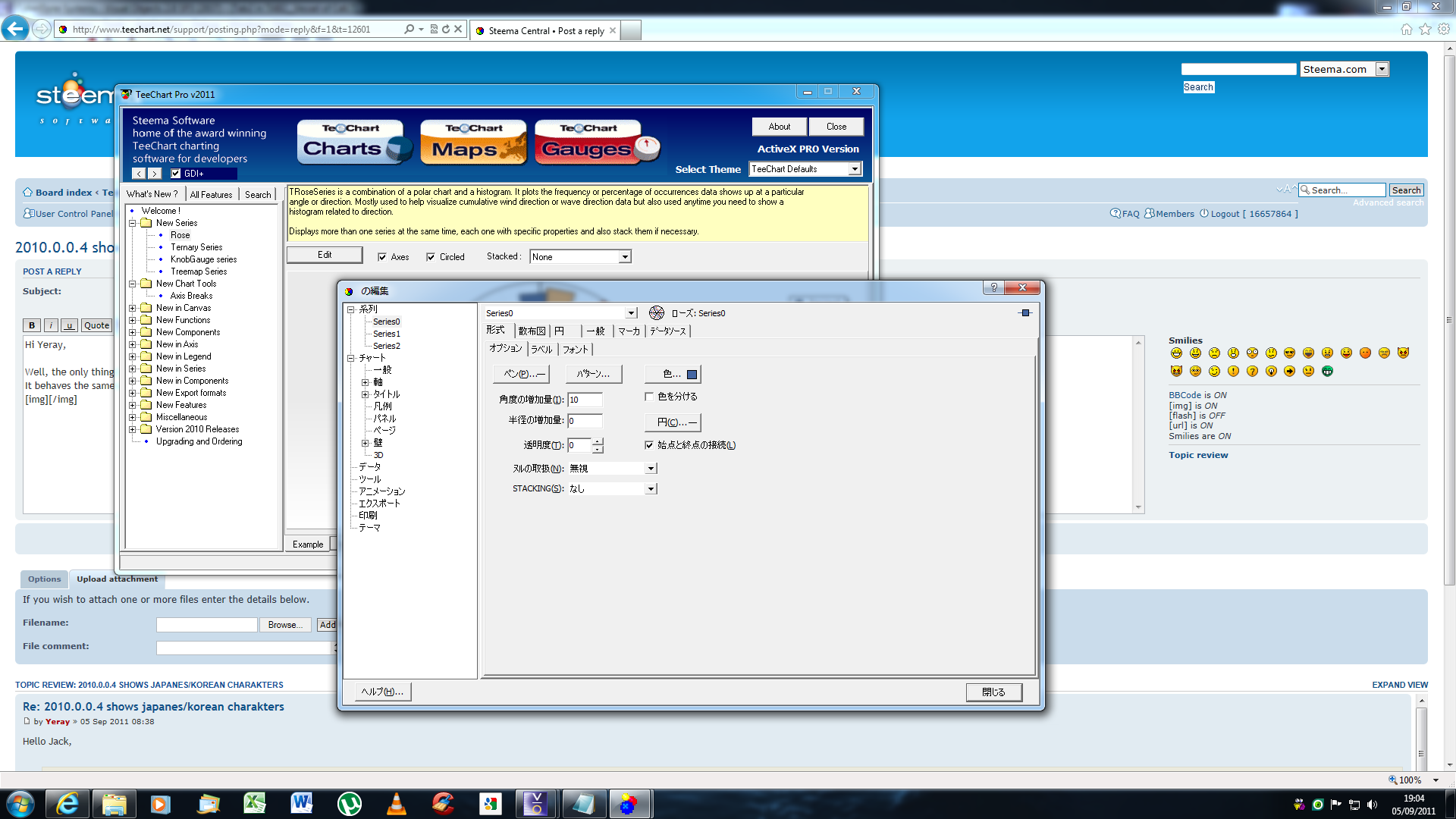

Like the title says. I donwloaded the latest TC2010.0.0.4 and installed it.
Now the editor is not in english but, i guess, japanes or korean.
What is wrong here?

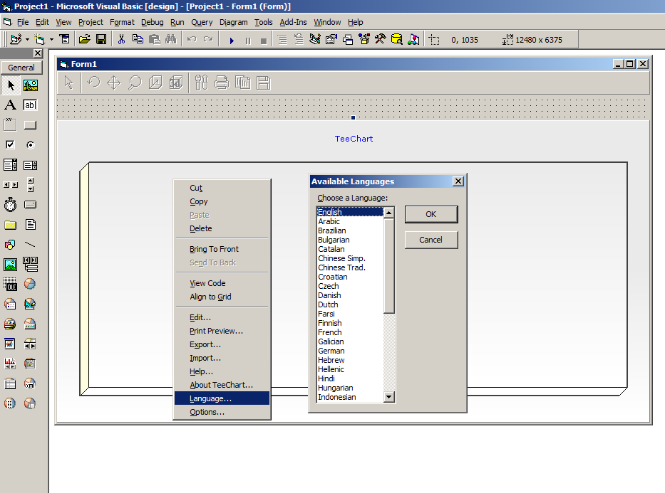

Hello Jack,
Did you have another version installed in that machine?
Can you change it in the design time "Language..." option (in the contextual menu)?

Well, the only thing i did was to uninstall the previous version (2010.0.03). After that i installed the new version.
It behaves the same under design and runtime.
When running the feature demo (new series, rose, edit) it also shows japanese/korean (see attachment).
Greetings,
Jack

Have you tried to change the language in the "Language..." option at design time, in the contextual menu?

How do I change the language ? Remember I can't read Japanese/Korean.
But let's focus on the feature demo. What actions should I take to see the editor in English ?

In VB6, the "Language..." option is the penultimate in the contextual menu, and "English" is the first language in the list. However, in another IDE, the "Language..." option could be into an "Options" submenu.

Thanks, That did the trick.
But it makes me wonder why TC behaved this way. It never did this before.
