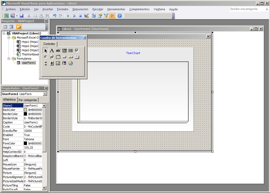

Re: ActiveX 2010 on Excel Form
Hello Jurgen,
Thanks for the steps. I could add a chart to the UserForm without problems. I'm on Windows 7 x64, Office Professional 2010 (14.0.5128.5000) (32 bits), TeeChart AX 2010.0.0.3.
