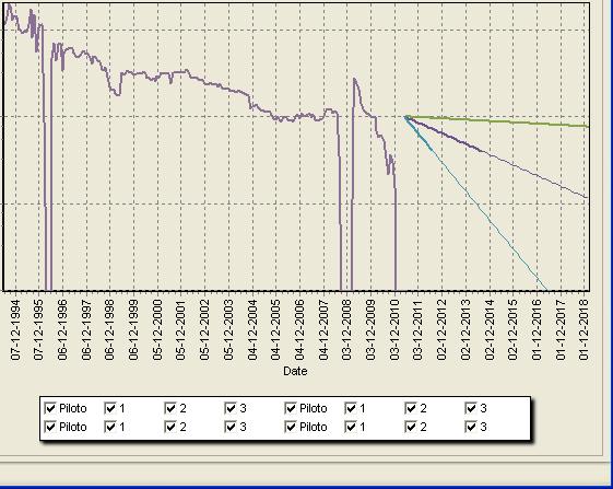

Hello, we just found that grouping series using SeriesGroup could be a way to solve our need, but we have the following issue:
Please refer to Ejecucion1.jpg:

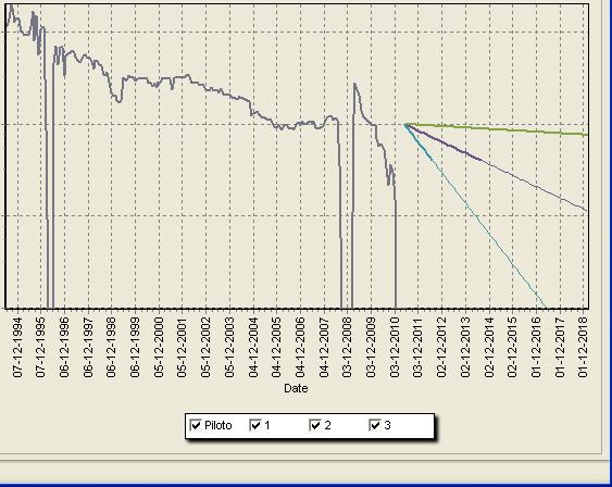

In this graph, the gray series belongs to the group named "PILOTO", the green line to "1", violet line to "2" and blue line to "3", but how can we assign a color to a series group?
and how can we display the color on a legend ?(but one color for each group).
Another issue: Any time that we click on the graphic to regenerate it (in the case we want another random color), the legend doesn't refresh but remains and cumulates with each click. How can the legend be refreshed and cleaned (Ejecucion4.jpg: note how after four clicks we now have the leyend four times).

- Ejecucion4.jpg (Second issue)
- Ejecucion4.JPG (54.55 KiB) Viewed 14357 times
- Ejecucion1.jpg (First issue)
- Ejecucion1.JPG (51.33 KiB) Viewed 14342 times

I'm afraid it's not possible to set a series group legend symbol. Note that a series group can be formed by different series types so TeeChart can't decide what symbol to use.JAV wrote:Hello, we just found that grouping series using SeriesGroup could be a way to solve our need, but we have the following issue:

However, you can always use custom drawing techniques to draw your symbols manually. Something as follows:
Private Sub Form_Load()
TChart1.Aspect.View3D = False
TChart1.SeriesList.AddGroup "First group"
TChart1.SeriesList.AddGroup "Second group"
Dim i As Integer
For i = 0 To 8
TChart1.AddSeries scLine
TChart1.Series(i).FillSampleValues
TChart1.SeriesList.Groups.Items(i Mod 2).Add i
Next i
TChart1.Legend.Alignment = laBottom
TChart1.Legend.CheckBoxes = True
TChart1.Legend.LegendStyle = lsSeriesGroups
End Sub
Dim i As Integer
For i = 0 To TChart1.SeriesList.Groups.Count - 1
TChart1.Canvas.Pen.Color = TChart1.SeriesList.Groups.Items(i).Series.Items(0).Color
TChart1.Canvas.DrawLine TChart1.Legend.Item(i).SymbolRect.Left, TChart1.Legend.Item(i).SymbolRect.Top + 5, TChart1.Legend.Item(i).SymbolRect.Right, TChart1.Legend.Item(i).SymbolRect.Top + 5
Next i
End Sub
I suspect you are recreating the series each time the chart is clicked, without clearing the chart. That's the easier explanation for your "increasing legend" problem. However, I'm not sure if that is really the problem as I haven't seen the project, and I'm not sure either if what you would like to do is to refresh the series data or completely destroy all the series and recreate them.JAV wrote:Another issue: Any time that we click on the graphic to regenerate it (in the case we want another random color), the legend doesn't refresh but remains and cumulates with each click. How can the legend be refreshed and cleaned (Ejecucion4.jpg: note how after four clicks we now have the leyend four times).

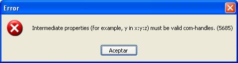

Thanks for replying. I think your suggestion is good, but in the next line I get the error attached in the picture. What am I doing wrong?
Regarding the latter point, indeed, I am recreating the series each time the chart is clicked, i don't know how clear the chart. I'm using:
TChart1.RemoveAllSeries
TChart1.SeriesList.ClearValue

I solved the error attached in the previous message by changing the original code:
by:
Perhaps the error occurred because I'm working with version 8 and not the last one.
TChart1.Canvas.DrawLine TChart1.Legend.Item(i).Left - 15, TChart1.Legend.Item(i).Top + 5, TChart1.Legend.Item(i).Left - 5, TChart1.Legend.Item(i).Top + 5
