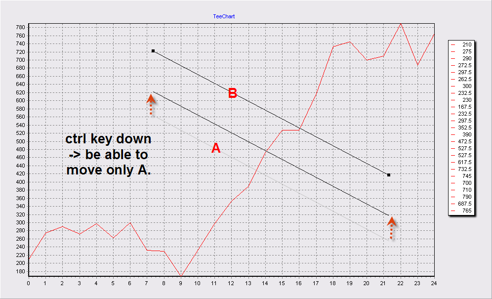

The 2nd thing is I would like to move only 1 line when I press ctrl button.
How can I do that Yeray ?
Thank you
Guilz

guilz2010
Posts: 63
Location: Paris, France
Re: Drawing lines and link them for moving and rotating
Post by guilz2010 » Thu Mar 31, 2011 12:53 pm
It's not good for me but it's probably beacause i'm not clear :D
My need: be able to select and move only 1 line when ctrl key is down only. In your code when i move 1 line the second one is moved too.
This need is to change the distance between 2 lines pressing ctrl key and moving 1 line...
Kind Regards Yeray
Guilz
Post by Yeray » Fri Apr 01, 2011 8:01 am
Hi Guilz,
Ok, Ctrl key to move up/down each line individually. Playing a little bit with the last code it could be possible:
Dim oLine, nLine As IDrawLine
Private Sub Form_Load()
  TChart1.Aspect.View3D = False
  TChart1.AddSeries scLine
  TChart1.Series(0).FillSampleValues
  TChart1.Tools.Add tcDrawLine
  TChart1.Tools.Items(0).asDrawLine.EnableDraw = False
  TChart1.Tools.Items(0).asDrawLine.EnableSelect = False
End Sub
Private Sub TChart1_OnDrawLineToolLineDrag()
  ForceLine
End Sub
Private Sub TChart1_OnDrawLineToolNewLine()
    Dim currentLineIndex As Integer
    TChart1.Tools.Items(0).asDrawLine.SelectNewLines = True
    currentLineIndex = TChart1.Tools.Items(0).asDrawLine.Selected
    Set oLine = TChart1.Tools.Items(0).asDrawLine.Lines.Items(currentLineIndex)
    With oLine
        TChart1.Tools.Items(0).asDrawLine.AddLine .StartPos.X, .StartPos.Y - 100, .EndPos.X, .EndPos.Y - 100
    End With
    Set nLine = TChart1.Tools.Items(0).asDrawLine.Lines.Items(currentLineIndex + 1)
    With nLine
        .Pen.Color = oLine.Pen.Color
        .Pen.Style = oLine.Pen.Style
    End With
    oLine.Pen.Style = psNothing
    oLine.Pen.Style = psSolid
End Sub
Private Sub TChart1_OnKeyDown(ByVal KeyCode As Long, ByVal Shift As TeeChart.EShiftState)
  If KeyCode = KeyCodeConstants.vbKeyShift Then
    TChart1.Tools.Items(0).asDrawLine.EnableDraw = True
    TChart1.Cursor = -3
  End If
  If KeyCode = KeyCodeConstants.vbKeyControl Then
    TChart1.Tools.Items(0).asDrawLine.EnableSelect = True
  End If
End Sub
Private Sub TChart1_OnKeyUp(ByVal KeyCode As Long, ByVal Shift As TeeChart.EShiftState)
    TChart1.Cursor = -2
  End If
  End If
End Sub
Private Sub TChart1_OnMouseMove(ByVal Shift As TeeChart.EShiftState, ByVal X As Long, ByVal Y As Long)
  ForceLine
End Sub
Private Sub ForceLine()
  If currentLineIndex > -1 Then
    If currentLineIndex Mod 2 Then
      Set nLine = TChart1.Tools.Items(0).asDrawLine.Lines.Items(currentLineIndex - 1)
    Else
    End If
    oLine.StartPos.X = nLine.StartPos.X
    oLine.EndPos.X = nLine.EndPos.X
    TChart1.Repaint
  End If
End Sub
The result isn't perfect. The dragged line is shown in it's temporal location and redrawn in its forced final location giving a flickering result.
I don't see how to avoid this easily. However, an option would probably be to hide the dragged line and use custom drawing techniques to draw the final location while dragging.

Hi Narcis,
Thanks for your contribution but It does not respond to my need (be able, when I draw 1 line to draw a second line automaticaly and after, when I move 1 line the second line is moved too and third, when I press ctrl key and clic on 1 line, only this line is moved (to change the distance between line A and B)
Please try the code I made, it's working pretty well now...Perhaps we can optimize it...
Guilz
Post by Yeray » Mon Apr 04, 2011 10:43 am
Hello Guilz,
So this is working as you would like, isn't it? If not, please, try to explain us what aspect would you exactly want to optimize.
