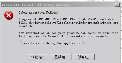

I use SetMaximum method to set the Maximum of the left axis ,but it happens a error. The attachment is the screenshot of the error.

Hello Candy,
Sorry for the delay, I have done some tests with your project and seems that chart.GetAxes().GetLeft() don't works correctly. We have added it in bug list report with number [TA05015453]. We will try to fix it in next maintenance releases of TeeChart.Net.
