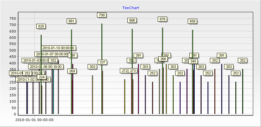

I use the SeriesXMLSource1 to add the data to my chart ,but it happens a error . The following is my code:
code:
LPTSTR LP;
CString STR;
m_pIndex++;
//Chart1 *m_Chart2;
VARIANT SourceSeries;
//m_Chart1.AddSeries(1);
UpdateData(TRUE);
SourceSeries.vt=VT_DISPATCH;
CSeries InputSeries=m_Chart1.Series(0);
SourceSeries.pdispVal=InputSeries;
//x axis lable format set
CAxes Axes;
CAxis Axis;
Axes=m_Chart1.get_Axis();
CAxisLabels Axislabels=Axes.GetBottom().GetLabels();
Axislabels.SetDateTimeFormat(L"yy-mm-dd HH:mm:ss");
//databinding
m_SeriesXMLSource1.SetFileName(L"D:\\DEV-DEMO\\SampleData.xml"); //This can also be a local file
m_SeriesXMLSource1.SetSeries(SourceSeries);
m_SeriesXMLSource1.SetSeriesNode(L"USA");
m_SeriesXMLSource1.SetValueSource(L"Bar");
m_SeriesXMLSource1.Open();
The attachment is the screenshot of error and the xml file. Is there something wrong in my xml file (The "X" is seted to a date value )?

The error message in your image makes me think that you could be loading an string directly as Xvalue without converting it to DateTime or Double.
If you still have problems with it, could you please arrange a simple example project we can run as-is to reproduce the problem here?
