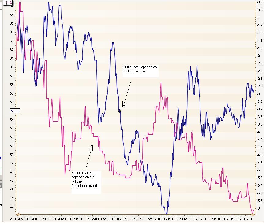

I have two graphs, one that depends on the left axis and the other on right axis and I would like to see simultaneously the coordinates of the two graphs on the respective axes on mouse move.
The problem is that I can not display the coordinates on the right axis (see attachment).

Re: Tee Chart Annotations
Post by Yeray » Wed Dec 29, 2010 2:23 pm
Hi Petar,
I've used your snipped of code in a simple application and I can't see problems in the result.
Could you please take a look at it and see if it helps you to find if there is something wrong in your application?

If you still have problems with it, please try to arrange a simple example project we can run as-is to reproduce the problem here.
