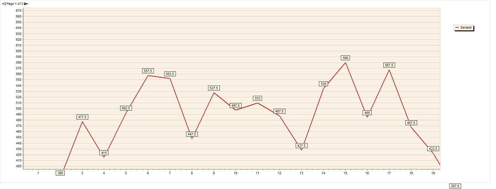

Is there a way to make the mark of a point visible if and only if the point is visible on the graph?
In the image above, the mark [357.5] still shows even when the point is no longer visible on the graph. I tried clipping; however, it clips the mark. What I want to do is to not show the mark if the point is no longer visible.

I tried that. The problem is it clips the marks. What I want to do is to not show the mark if the point is no longer visible on the graph. However, if the point is still visible, even though the mark will be off the graph, I still want to show the mark.

Ok. I made a simple code that uses method of series CalcYPos(i). I think you can use it for solve your problem with marks in your application. Moreover we can added it request in wish-list with number (TV52015303) to be enhanced for next releases.
Private Sub Form_Load()
    TChart1.Aspect.View3D = False
    TChart1.AddSeries scLine
    TChart1.Series(0).FillSampleValues 25
    TChart1.Series(0).Marks.Visible = True
End Sub
    Dim yPos As Integer
    For i = 0 To TChart1.Series(0).Count - 1
        yPos = TChart1.Series(0).CalcYPos(i)
        With TChart1.Series(0).Marks
            If (yPos < TChart1.Axis.Left.IStartPos) Or (yPos > TChart1.Axis.Left.IEndPos) Then
                .Item(i).Hide
            Else
                .Item(i).Show
            End If
        End With
    Next
