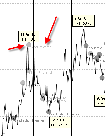

Hi Teechart support Team,
2 questions:
1 - How can I change Mark text without using _OnGetSeriesMark method (I would like to change mark text for 1 serie not for all my series) ?
With AxTChart.Series(AxTChart.SeriesCount - 1).Marks.Item(nbMarks)
End With
->but unfortunately the .Text property is readonly...
2 - My need is to display information on my chart (a symbol and a text -> gray circle and Island Reversal text in my example)) like in the chart bellow:
What is the best way to do this ?
Thanks for your help
Guilz

Guilz wrote:2 - My need is to display information on my chart (a symbol and a text -> gray circle and Island Reversal text in my example)) like in the chart bellow:
Here you have a simple example showing how to achieve a chart similar that the picture you've attached:

Guilz
Posts: 46
Joined: Mon Nov 13, 2006 12:00 am
Re: Display text and symbol information on a chart
Post by Guilz » Thu Nov 25, 2010 12:01 pm
It is working like a charm, as usual :wink:
Thanks a lot

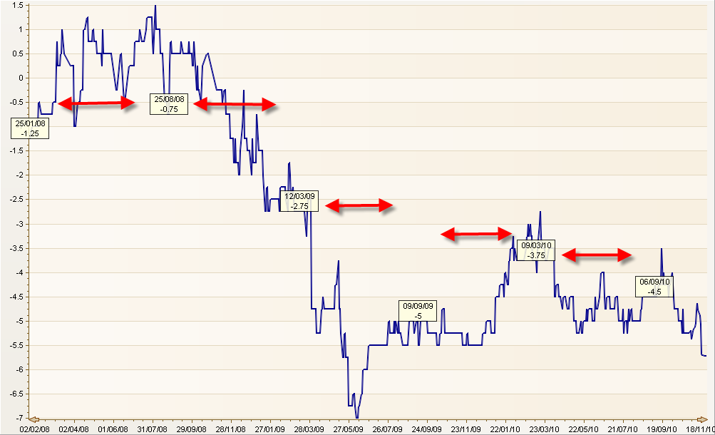

Post by Guilz » Thu Nov 25, 2010 2:52 pm

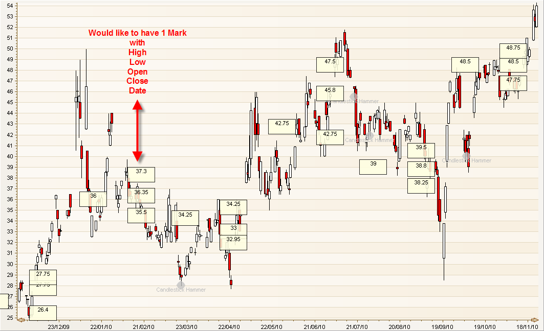

I have an another issue with marks:
We use marks on chart and create function to let space between marks (for readability problem)
But on Candle Chart we would like to have the same logic with only 1 mark (Open, Close, High, Low and corresponding date) and not one mark for Open one mark for close one mark for High like in the screen shot bellow...
How can we do that ?
Guilz
Post by Sandra » Thu Nov 25, 2010 4:38 pm
Hello Guilz,
You can use in OnGetSeriesMark event a code as the next:
Private Sub Form_Load()
TChart1.Aspect.View3D = False
TeeCommander1.Chart = TChart1
TChart1.AddSeries scCandle
TChart1.Series(0).FillSampleValues (5)
TChart1.Series(0).Marks.Visible = True
End Sub
Private Sub TChart1_OnGetSeriesMark(ByVal SeriesIndex As Long, ByVal ValueIndex As Long, MarkText As String)
MarkText = "Data:" & Str$(TChart1.Series(0).asCandle.DateValues.Value(ValueIndex)) & vbCr & "Open" & Str$(TChart1.Series(0).asCandle.OpenValues.Value(ValueIndex)) & vbCr & "Close" & Str$(TChart1.Series(0).asCandle.CloseValues.Value(ValueIndex)) & vbCr & "High" & Str$(TChart1.Series(0).asCandle.HighValues.Value(ValueIndex)) & vbCr & "Low" & Str$(TChart1.Series(0).asCandle.LowValues.Value(ValueIndex))
End Sub
Could you tell us, if code works as you want?
Guilz
Posts: 46
Post by Guilz » Thu Nov 25, 2010 5:19 pm
Hi Sandra,
It is not working fine for me -
For Candle chart type, I would like to have less Marks for readability problem.
In fact .Marks.DrawEvery property does not work fine with candle type (see my picture to understand the problem)
Guilz
