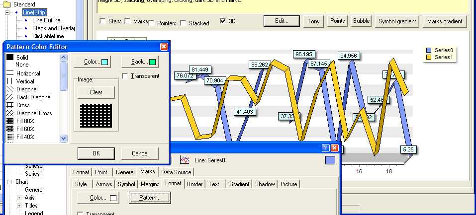

But I don't want to change the colour of the marks. The setting is the background colour of the surrounding box around the marks, its the background of the box that the mark is in (if that makes sense). I can change it using the editor, but I need to be able to do it in code.
If you look at the attached, the marks box has a colour white, pattern colour light blue and the pattern is "fill 80%".
Does that make sense?

Post by Sandra » Fri Oct 15, 2010 8:52 am
Hello Tony,
I fear its that this is a bug known of the brush object (TV52015167). I have increased its priority and we try to fix it for next maintenance releases.
