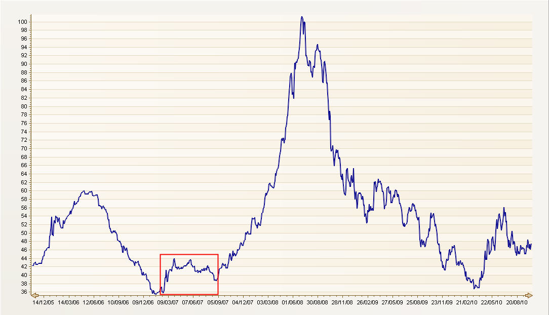

How can I implement a function to find optimal min max axis after zooming ?
I use SetMinMax function but it does not work, the max value of my serie (for current zoom range) is not on the top of the max axis

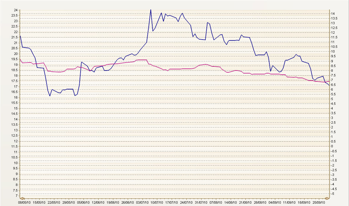

And the result is not correct as bellow...
How can take in account the left and right axis ?
Thanks for your help...
