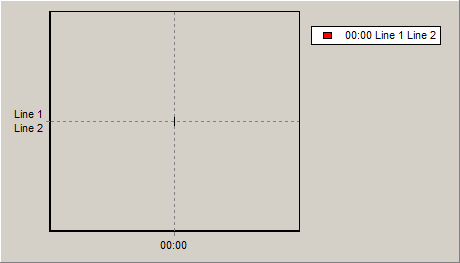

See the attached image.
I selected Axis->Labels->Style->Multi-Line, and then tried setting the x axis label to have two rows.
But I get the strange character. I initially tried sending a Unicode string, then tried a UTF8 string, both have the strange character in it.
Is there any way around this?

Hi Tony,
The following seems to work fine for me in VC++ 6.0
If you still have problems with it, please try to arrange a simple example project we can run as-is to reproduce the problem here.
m_Chart1.AddSeries(scGantt);
CString strModifiedTitle = "Line 1\rLine 2";
m_Chart1.Series(0).GetAsGantt().AddGantt( 0 , 0 , 0 , strModifiedTitle);

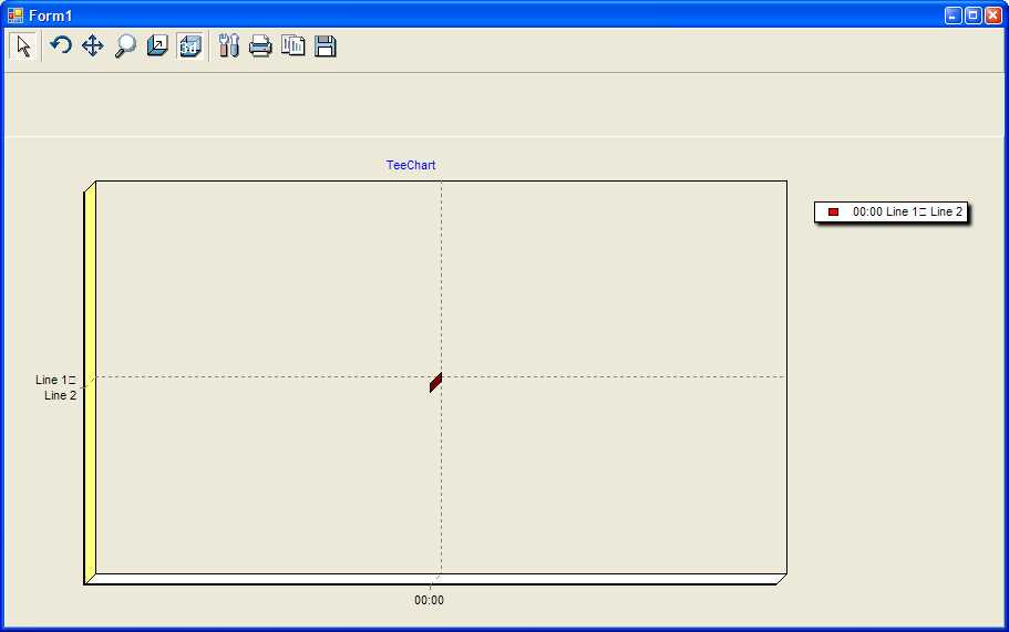

Re: Strange characters in axis labels.
No, this does not work.
I cannot upload the attachment, I get an error "Sorry, the board attachment quota has been reached."
I've uploaded it (the file is called TChart_funny_charsLatest.jpg).
All I did was build the test project and run it.
Let me know if you need anything else.
Tony.
Tony.

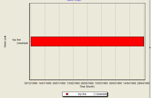

Here is the file again.
- TChart_funny_charsLatest.jpg (22.85 KiB) Viewed 22427 times
