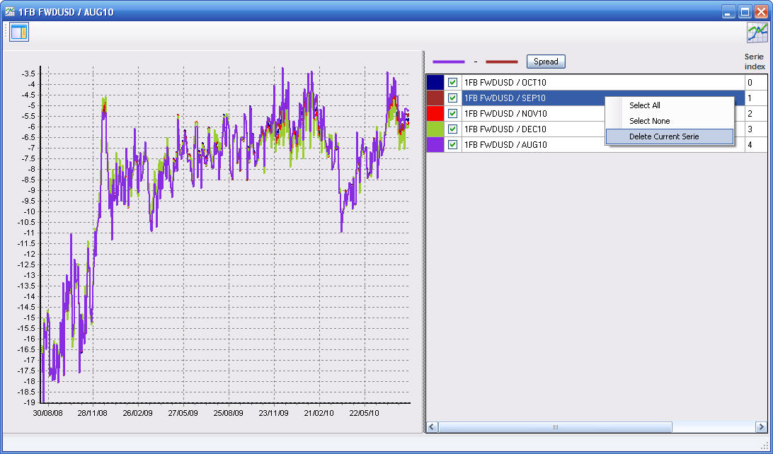

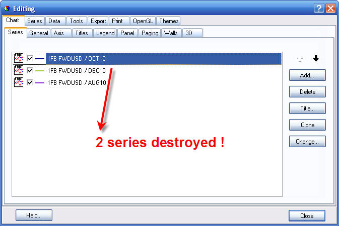

I would like to know if RemoveSeries method is the only method to delete specific serie on Chart ?
When i use RemoveSeries(1) method on my chart (5 series available), 2 series are destroyed (index 1 and 2) !
If I use Delete Bouton available on TeeChart Editor Control it is working fine (only 1 serie is destroyed)
I expect I do something wrong but I don't see where is my mistake...
Could you help me ?
Thks a lot

Hi Guilz,
Yes, this is a known bug already in the defect list to be fixed asap (TA05014784)

Hi Guilz,
I glad to announce that we've already fixed this problem (TA05014784).
I've sent the new ocx that includes the fix to the mail you have registered in this forums.

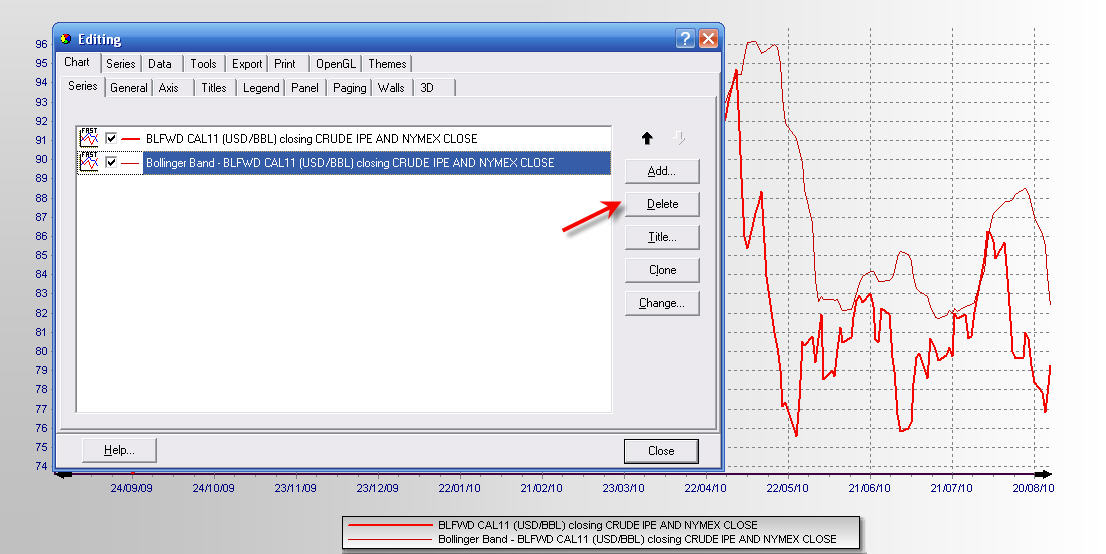

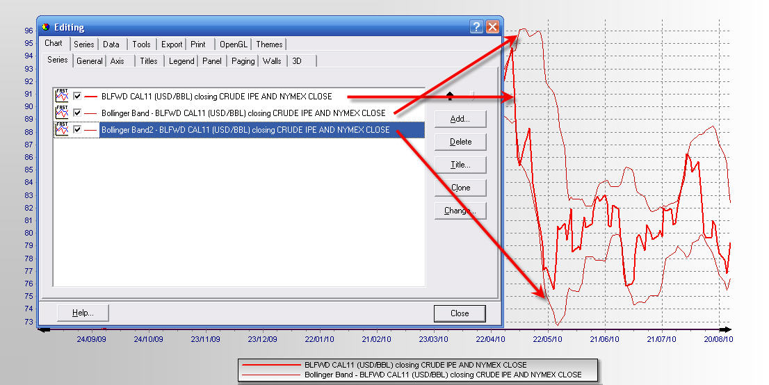

In my previous post about Bollinger you suggest to set property ShowInEditor to True to display it in Editor.

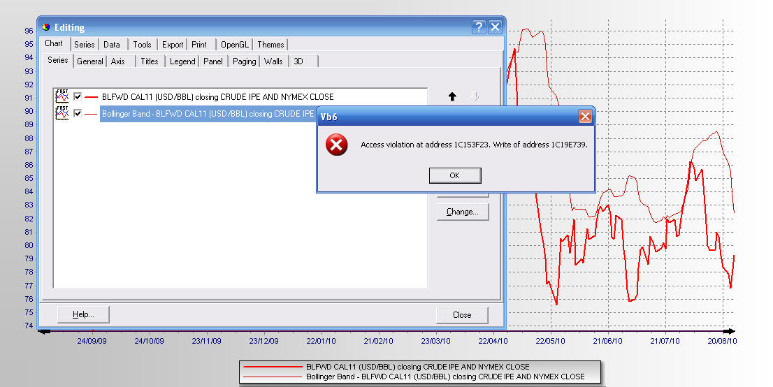

Look at this new issue: when trying to delete the first serie of bollinger series, Teechart component crash
At this step we delete Bollinger Band2. Working fine
Now, we will try to delete Bollinger Band1:
It is crashing with VB6 environment and with .Net.
Could you fix this issue ? Crash is never welcomed :lol:

Is the purpose of making visible the internal series to destroy it? If you don't want it to be shown you can simply set it Active = false.
However, you are right that having a source series and a bollinger function the IDE crashes if you try to remove the two last series, so I've added it to the defect list to be fixed in future releases (TA05015119):
  TChart1.Aspect.View3D = False
  TChart1.AddSeries scFastLine
  TChart1.Series(0).Pen.Width = 2
  TChart1.Series(0).FillSampleValues 100
  TChart1.Series(1).SetFunction tfBollinger
  TChart1.Series(1).DataSource = TChart1.Series(0)
  TChart1.RemoveSeries TChart1.SeriesCount - 1
